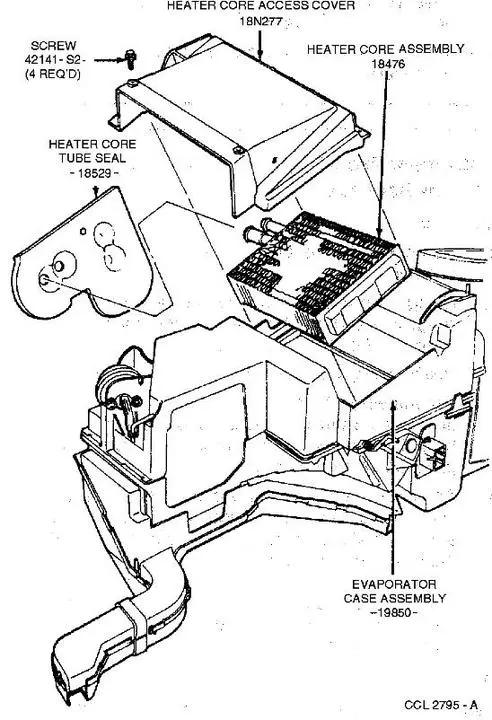

Here's what my ALLDATA says:
Hope that helps.
