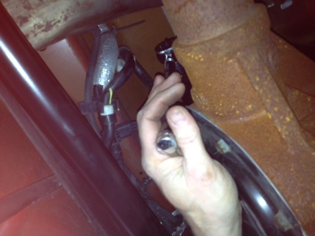

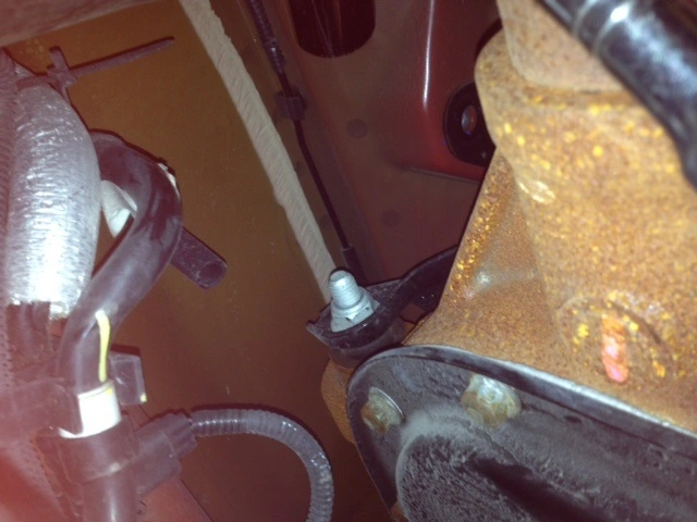

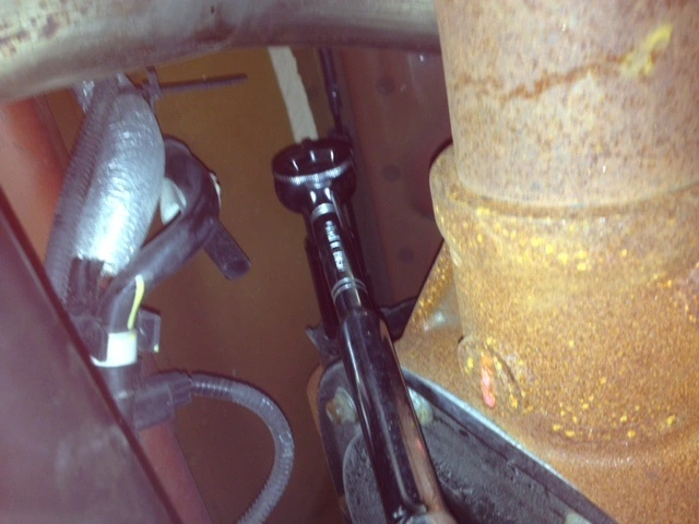

Next, I used the 1/2" ratchet and socket only, no extensions, to remove the nut (see pic) on the passenger side of the top of the differential. The space was really tight and only got 2 clicks on the ratchet at a time. Used the rear sway bar and panhard bar to brace against. Once it was broke loose, I put another ratchet on the bolt head side to hold it (swung so it was against something to brace it) and used an extension and swivel adapter to take the nut off the rest of the way. On into the interior, removed the rear seat to remove the uca mount bolt. Only had a deep 24mm socket and it needed so much torque, it would slip off. Buddy had an electric impact wrench he wanted me to try. No go. Grabbed a neighbors 24mm socket (not a deep socket), put it on the breaker bar, knelt on the ground with drivers door open, reached into the car and used the car to pull against and it came off easier than I expected. Had to support the car at jacking points to let the rear droop so I could get the arm/mount out. Have the new Steeda mount and adj. arm ready to go in and it should go in easier than it came out. Like everything, if I had to do it again, would be much quicker!
The pictures show (l to r) the rear diff. with the nut on top. Same pic with socket wrench on the nut. Hand on the wrench showing how little space there was.
