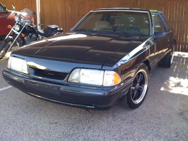

Here's mine with 17x8 sn95 wheels and 245/45/17. A 255 might clear, but rolled fenders and not being too lowered would be a must.

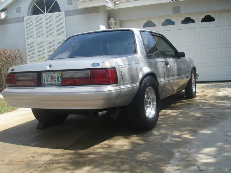

235/45/17 in front...Mach 1 springs all around
Thank you thank you! Really appreciate the pics!
I'm planning on rolling the fenders and I was planning on lowering the car (1" rear and 1.5" fronts). Hopefully I'll be good to go here.
