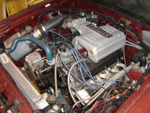

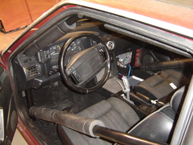

recently started to complete my 91 lx hatch drag car.
i bought the car new in spring of 92. has 55,000 original miles.
347 stroker na with a c-4 transbrake tranny.
full cage and everything has been removed that does not make it go or stop.

whats your hp? or track times? looks like a good time.
no times yet.
i took the car apart 8 years ago and life got in the way.
taking it to the dyno tuner soon. i have an old anderson pms but i'm thinking of having the tuner just burn a chip instead.
car has a probe 347 stroker kit, steel crank, h-beam rods, custom ground cam motion cam, fully ported gt-40 heads (flow 225 on the intake), cobra intake, 65mm tb, good oil pan with a crank scraper, 11.5 to 1 compression.
full aerospace race brakes (front and back), upr k member, coil overs (front and rear), eaton posi with a 4.10 gear, 31 spine moser axels, c-clip eliminators.
c-4 trans, full ati treatment.
i just bought the mickey thompson drag radials for the back. i used to use slicks but i'm going to give the radials a try.
we will see what the tuner says.
