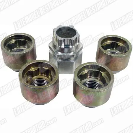

Stock pony wheels came w/ a wheel lock. Does it look like this?
If so, then get a factory key and pull them off.

Ford put factory locks on 87 and newer cars at least. Mine had them on the valuable 10 holes that came with it.
I've lost a couple of the keys before. My local Ford dealer has a master set of keys and they've taken them off for me twice now, and free of charge both times! If they look like the above locks, Ford probably has the keys in their service department.
