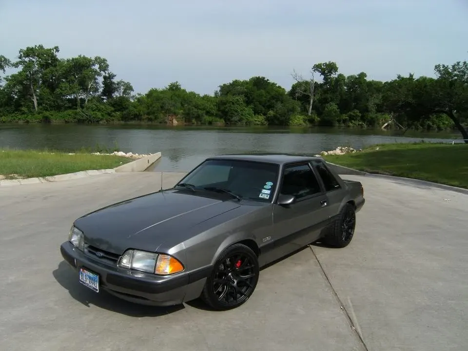

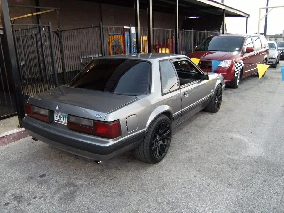

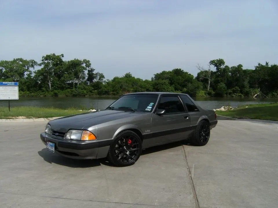

Here is my '89 LX with 255/35/18 on 18x9 front and 275/35/18 on 18x10 rear. You have to modify the fender spat and splash shield on 79-90 fenders. Roll both front and rear fenders.
