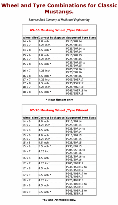

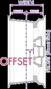

On a 8" rim, 0 offset = 4" backspace
your 5.5" backspace = 1.5" offset (I forget which way is + or -)
You should be running 4"- 4.5" BS acording to the Dodgestang chart :hail2:
http://www.dodgestang.com/Tire%20Fitment%20Guide%2065-6.pdf
This is and isnt entirely true. Backspacing is measured from flange the hub sits sits on to back side of wheel. A 8" advertised wide wheel isnt really 8" wide, its 9" from lip to lip. So an 8" advertised rim with 0 offset would have 4.5" backspacing.
