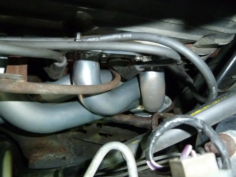

Also, If I go with the P heads in need to make sure my headers wont have clearance issues with the spark plugs. The headers are some knock off brand. Soon, I'll post a pic of them installed showing current clearance with my E7's. Maybe you guys can look at clearance in the picture and tell me if you think they'll work with the P heads.

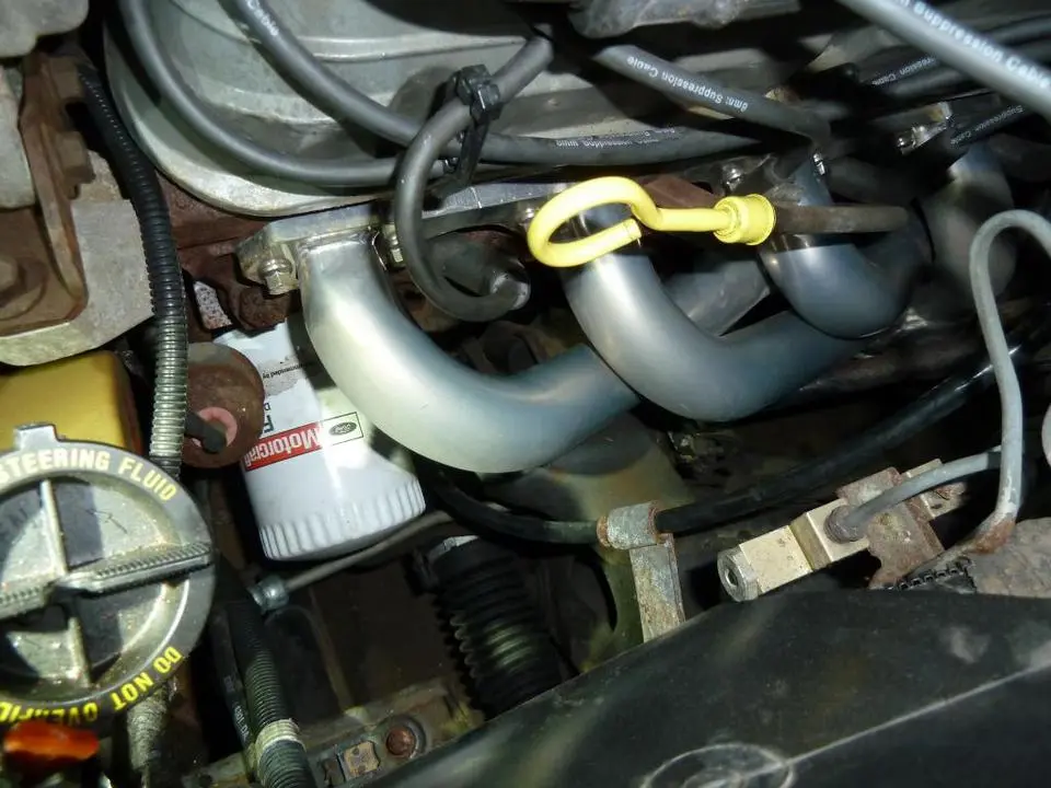

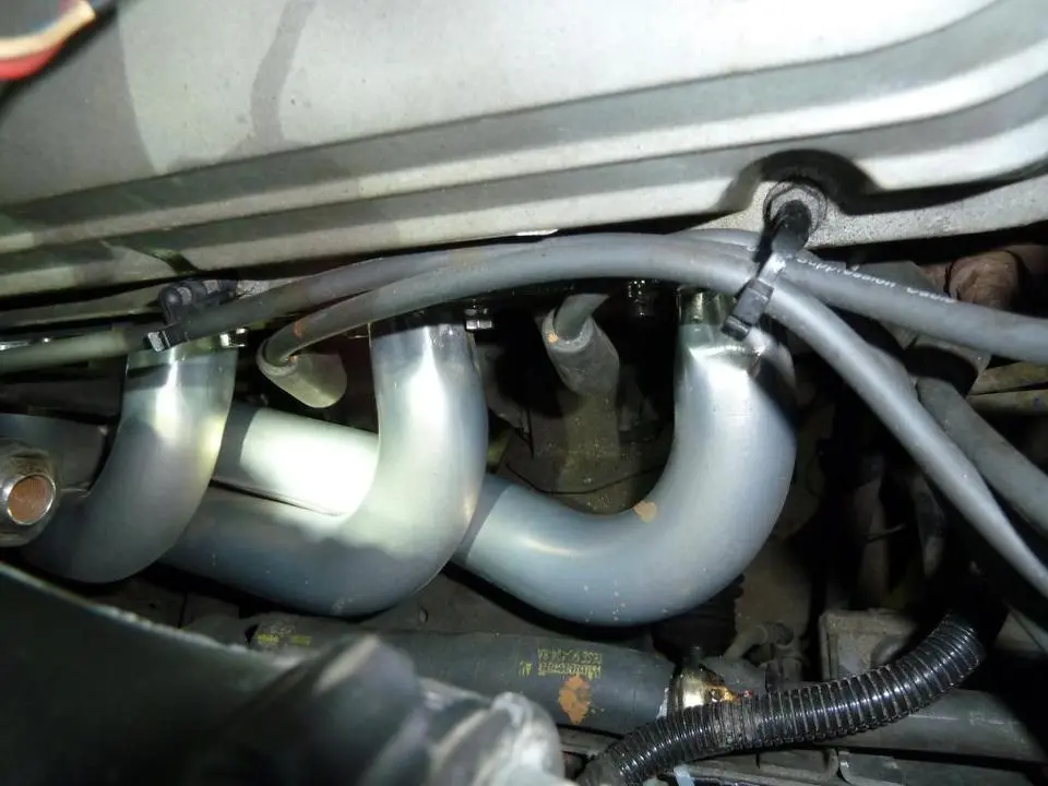

Here's the pics of installed headers on E7's. Looks like plenty of room for the slightly different angle of the GT40P heads, wouldnt you say? But the dipstick tube (pic 3) might present a challenge. What can be done about that?
