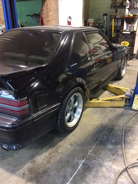

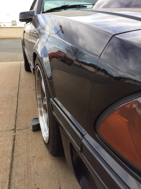

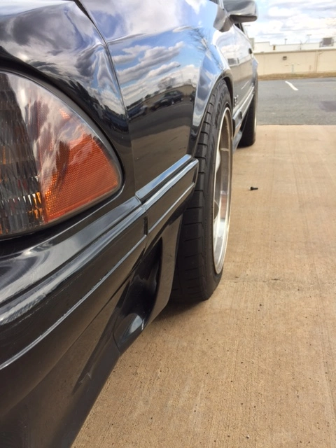

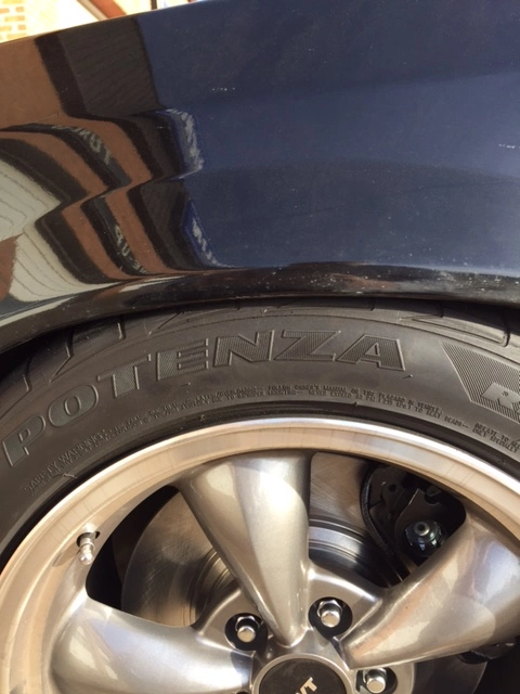

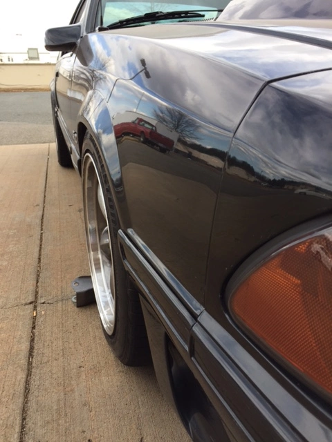

So...After installing 1995 frond spindles, the fender is sitting on the tire :fuss:....This was unexpected.
I run 17x9 bullits with a 245/45/17 front.
The car has been lowered with Eibach lowering springs.
How do I know if Rolling will be enough (I know nothing about this procedure or how much room it will free up)?
Or if pulling is the better option?

Do you have the Eibach Sportlines? Rolling your front fenders might gain you anywhere from 1/8" to 3/16" additional clearance. That will help you with up travel however your car is so low that anytime you turn the front wheels and hit a bump you'll have contact. Either a shorter/narrower tire or raising the front end up a little will cure this.

I didnt expect it to be this low..it wasnt a problem until i REMOVED factory spindles and went to 1995 spindles

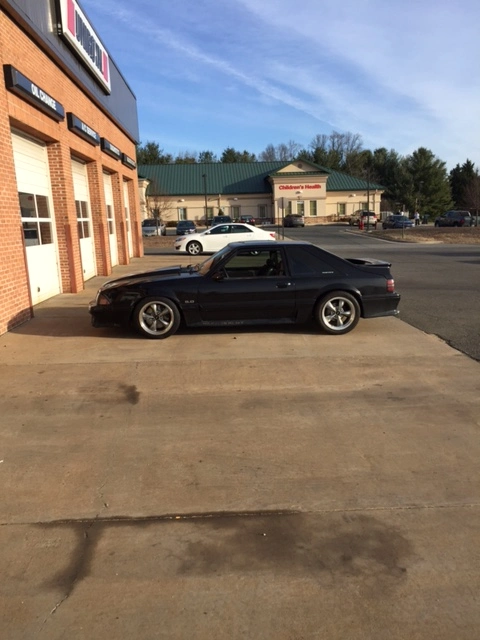

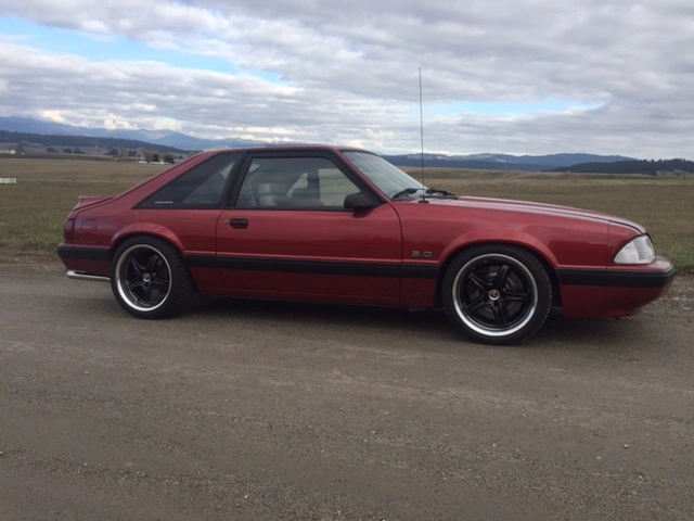

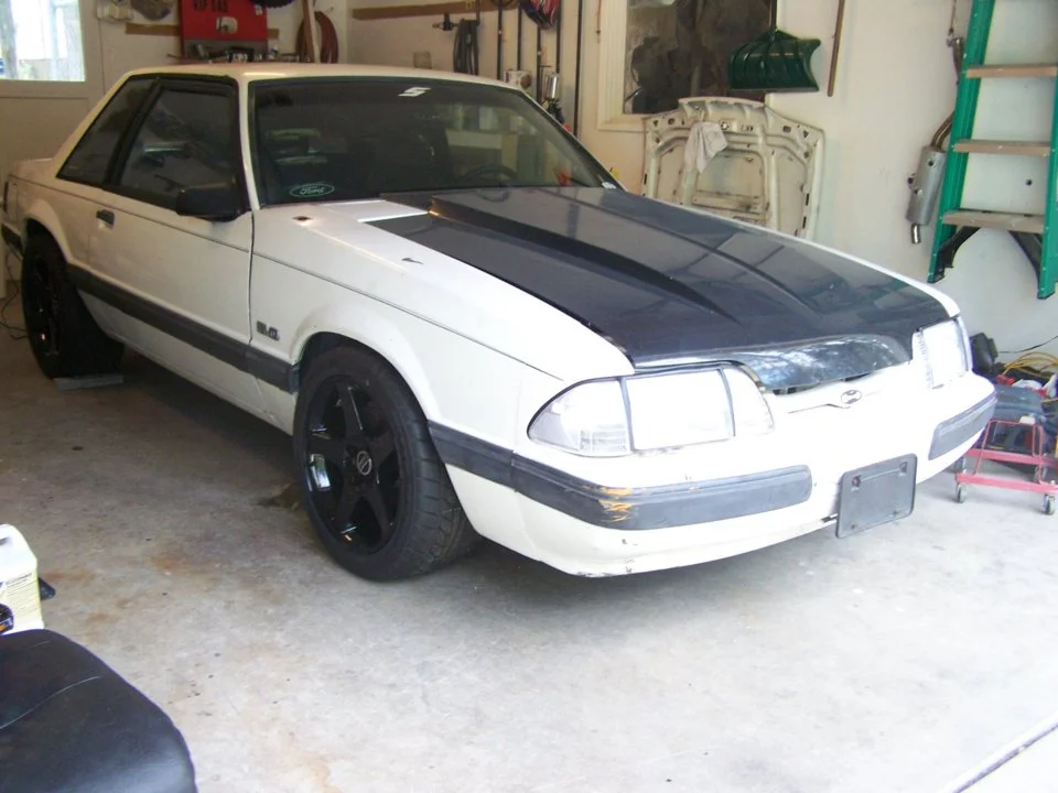

Here's my car. I did not roll or pull my front fenders. I have 235/40/18 up front and have no rubbing ever. Center of fender is at 24.5" IIRC from the ground.

Figured it out....I think
Its an alignment/Camber issue. The RF tire is perfect. Ride height on both is 24.5"
Need to get it onto my alignment rack and install the camber plates.
I'm still gonna have them rolled to avoid contact when suspension travels and wheel is turned
Reactions: FoxMustangLvr
I';m gonna loosen the mount bolts for the LF position and shift it a little, just So I can drive it onto the rack. That'll give me a little more negative camber on that side.

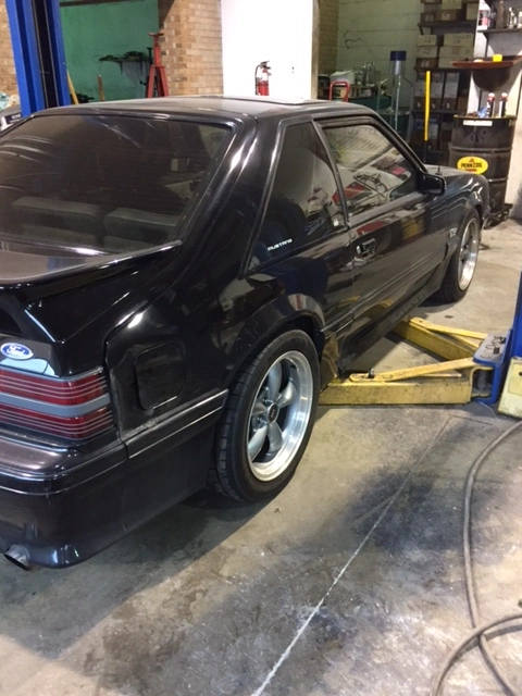

Will, I backed it out of the lift bay and drove it around the lot for a lap, then I heard it and parked it where it sits now.
Just wanted to test my brake continuity after the conversion.
Guess I gotta align it first:eek:

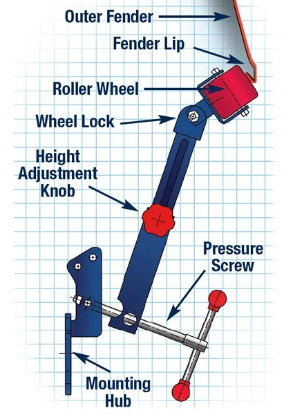

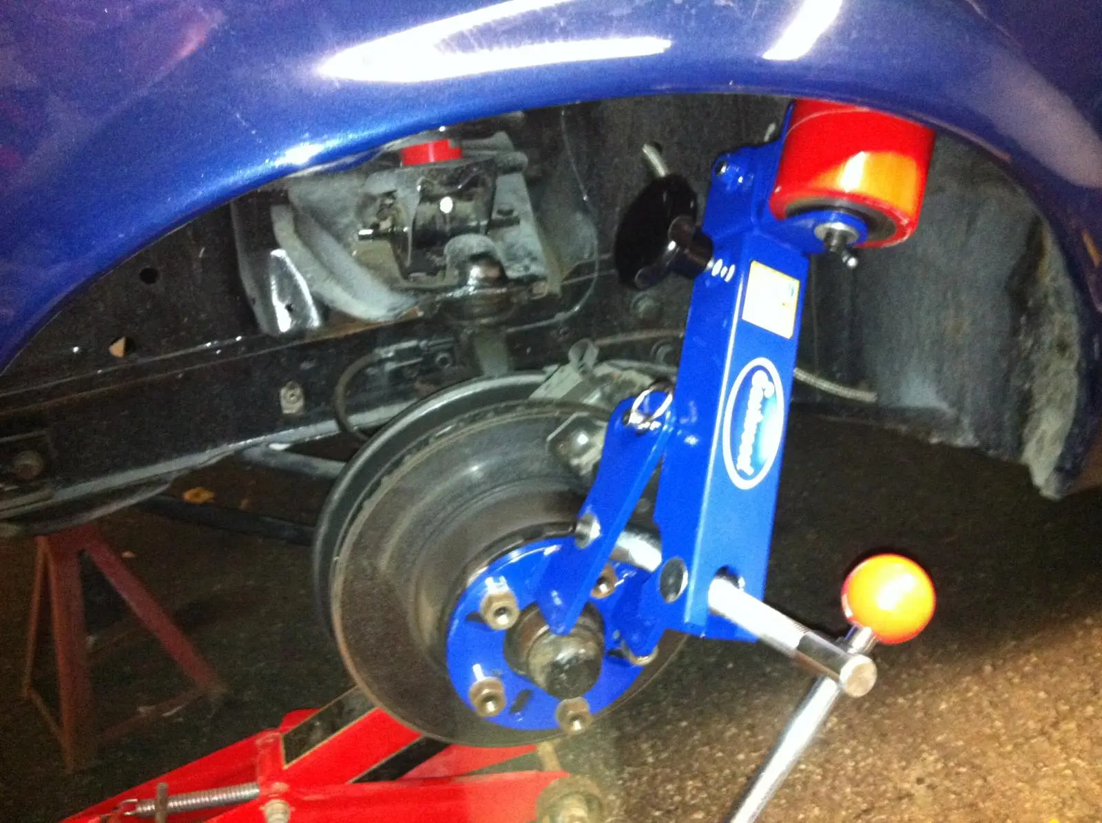

I'm not even sure you can roll the front fenders. I've seen that tool used on the rears all the time, but can it be used on the fronts without just pushing them out completely?
