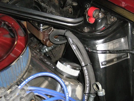

The Borgeson box install on my 68 went well and I can't believe the difference in the way the car drives. True night & day difference. The only thing I don't like is the way the hoses route across the inner fender. It looks terrible and also I get some vibration from the hoses at low speeds when turning lock to lock. How have others routed their hoses for this install? If you have it looking good, please post a picture. Thanks,

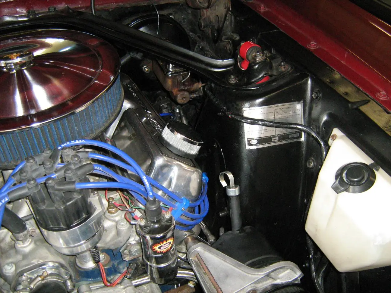

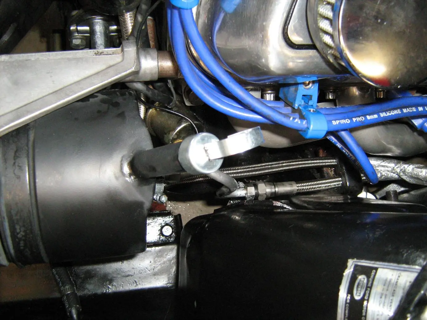

I came to the conclusion that I would have to get hoses made. It came out pretty good routing through the stock bracket. I may have to modify the rubber in the bracket a bit to get more header clearance, but looks much better. I'm not sure why Borgeson didn't do a bit more R&D on the hoses. For $80 you'd think they would look halfway decent.
