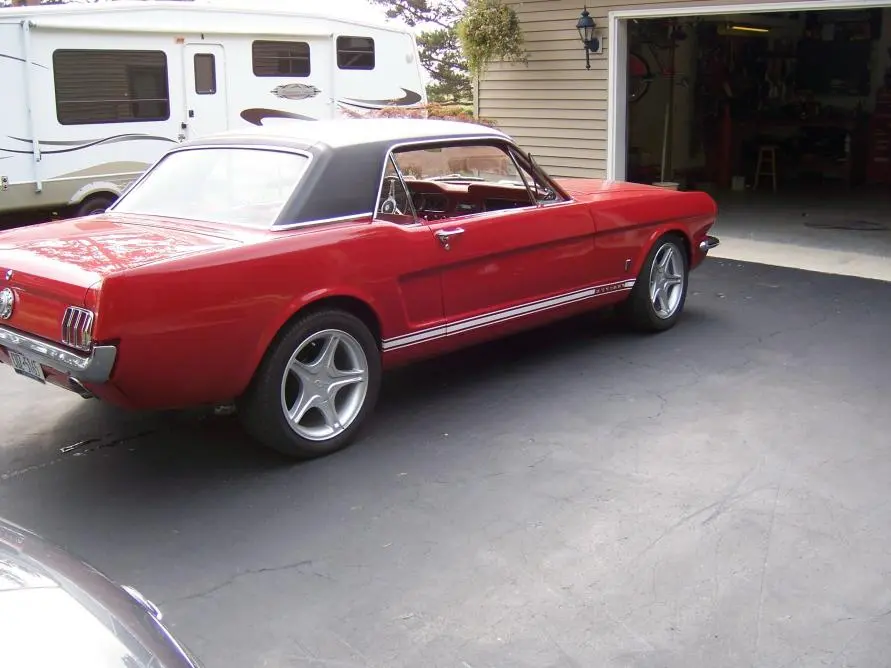

You'll never center the wheel in the wheelwell on a 65, Ive had 3 and all of them had the wheel in a similar position and not even close to enough adjustment to center it. That being said, those wheels/tires stick out too far, I was able to run 245/17's mounted on 8 inch late model mustang wheels with no spacer(willwood brakes to increase track width) with slight rubbing but the car handled awful, it just didnt track well down the road. I had the front wheels narowed to 7" and now run a 205/50 tire and it handles like a dream.
Ive attached a pic with the 245's on 8 inch wheels in the rear and 205/50s on the narrowed 7's in front, again NO spacers on this car, it uses a wider 67 9" rear axle, willwood brakes on the front.
