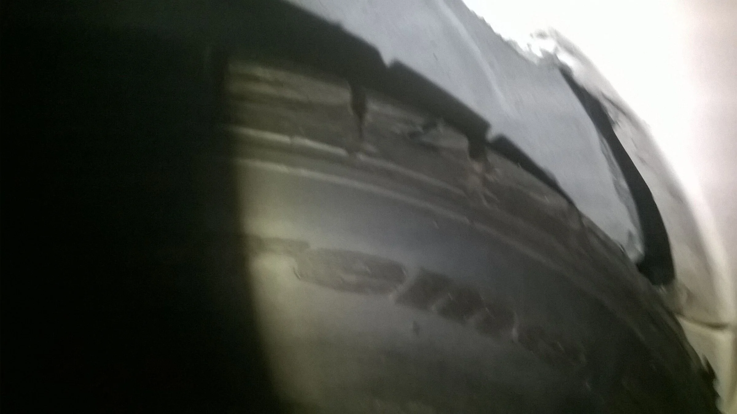

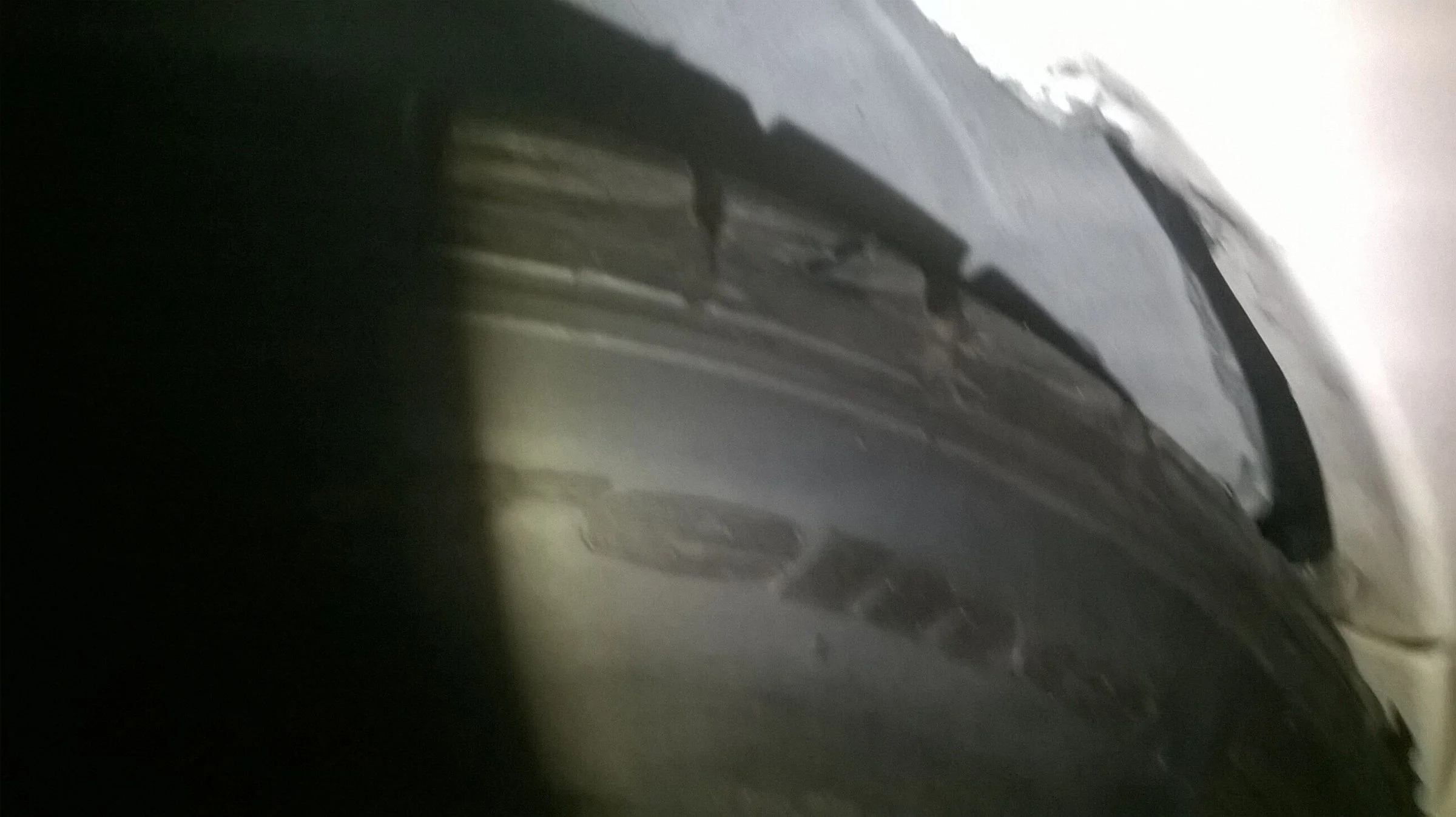

Hey, thank you for helping to try and figure out my problem. Just got to my computer and seen your replies so I took a couple photos but it is by a guy holding a flashlight in one hand and a phone in the other at 11pm . They don't show much. The tire damage is mostly on the passenger side . The tire is rubbing on fender . Not over speed bumps but while say turning right into a fast food parking lot where the parking lot is slightly at an incline. I also just noticed while trying to get a pic. that the left side has about 3 inches between fender and tire with minimal rubbing damage and the right side has about 5 inches between fender and tire parked on flat concrete. This is the side with the most damage. My rear tire size is 295-45-zr18. I bought her the car as a Christmas gift so I am still learning the car. My problem must be a worn suspension part because many other stangs run 295s with no issue but which one? shocks, springs, something else? I don't believe the previous owner did any maintenance or upgrades. Its at 113,000 mi. I put 1000 on it.
One more clue is , if I go over a bump , no rub. If I encounter a slight dip , scccrrrape. Also It tends to scrape more while there are passengers. I have all the tools and a brain but don't have time to play eenie Minnie mo with a cars parts I barely know. If any of this sounds familiar to you guys please help me stop destroying 200 tires.
I do know how to work on cars but have never had a race car to learn from. Sincere thanks for helping this dummy figure out his wifes car over the internet.

I have not mounted the new tires yet which are 285-35-18. The ones I'm having problems with are 295-45-zr18. Mainly the right side is rubbing on the fender lip at the 2 o clock position. Its a matter of time until It blows if it keeps rubbing. The tread is 90 % and I hate to trash a tire and know I could have had two hookers and a pizza with the 200 bucks for its replacement.. It must be suspension that will remedy the problem but where to start?
