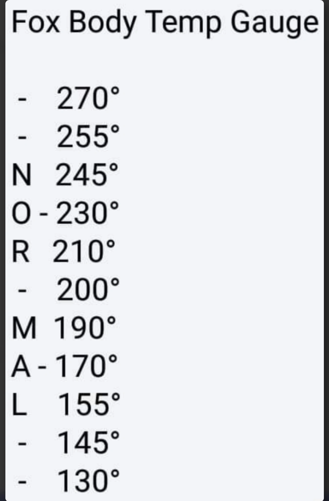

Factory gauge is notorious for being inaccurate, but the gauge roughly translates to something like this.
I checked my gauge against a mechanical and it does somewhat line up. Take it with a grain of salt.
If you want to see how inaccurate the stock gauge is, turn the ignition to run, engine off then turn on the headlights, sit and watch the temp gauge climb on its own. It will peg the gauge on almost every Fox body.. Check it with a real gauge and note where stock one reads with engine running, it varies. Most of my cars don't even have the stock gauge connected any more but most never got past the half way point even above 200* in traffic with the AC on. alot never even hit the third line. Between the old wiring and what's left for sending units and them cheaping out on suppliers these days I would not put much trust in them.
