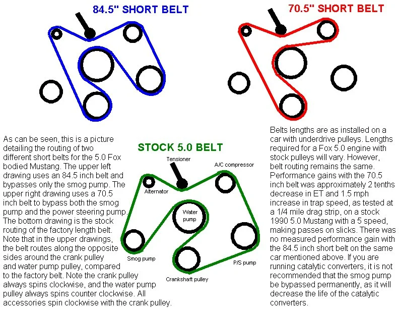

Go the short belt route. Here a a couple of diagrams and belt lengths.....

Those short belts look too complicated, lol...
Mine runs from the crank, up around the alternator, and then back down across the water pump. I bypass the Power steering (I dont have smog or AC anymore) and although I dont have any actualy proof of gains, it sure doesnt hurt!
