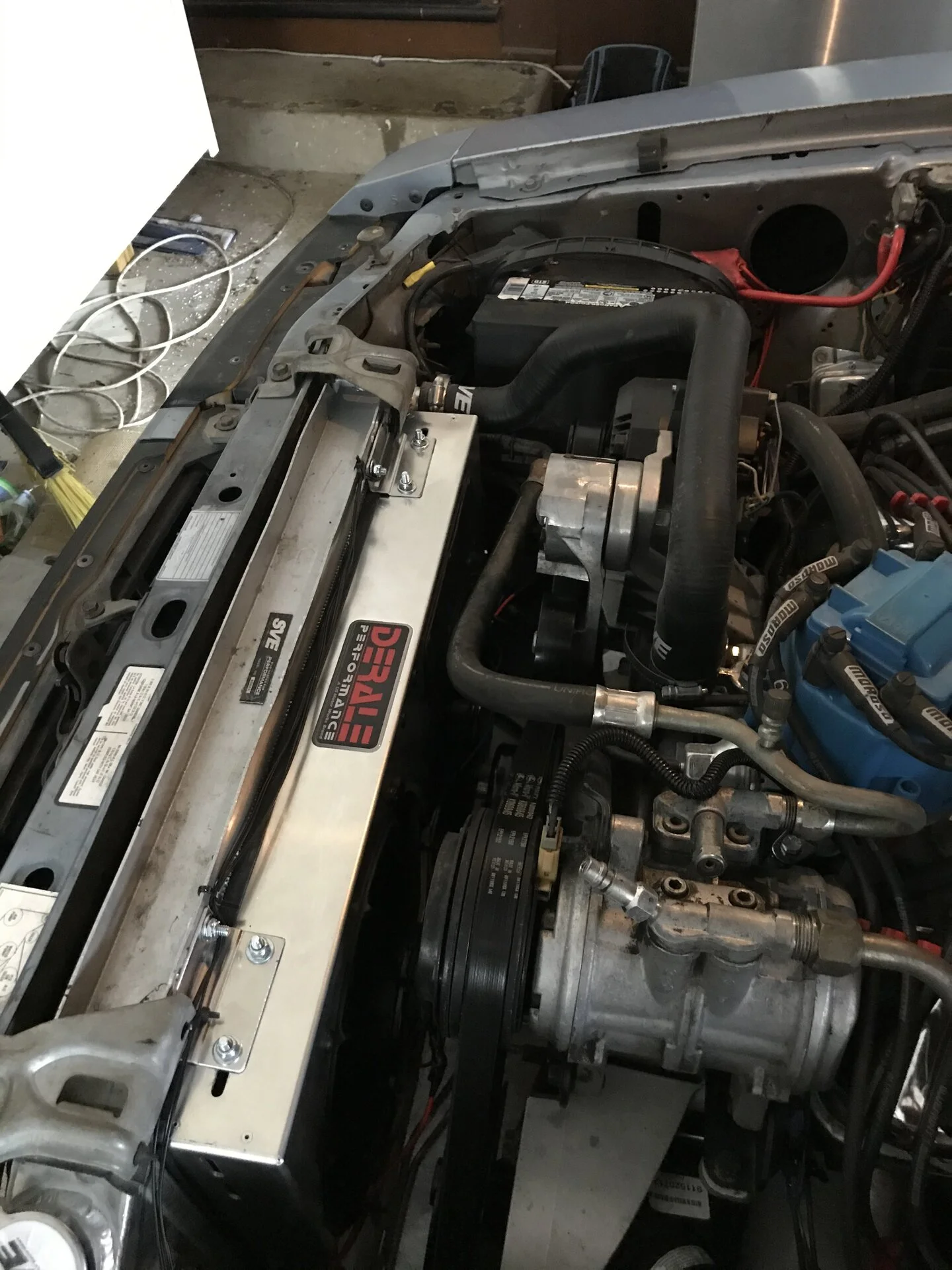

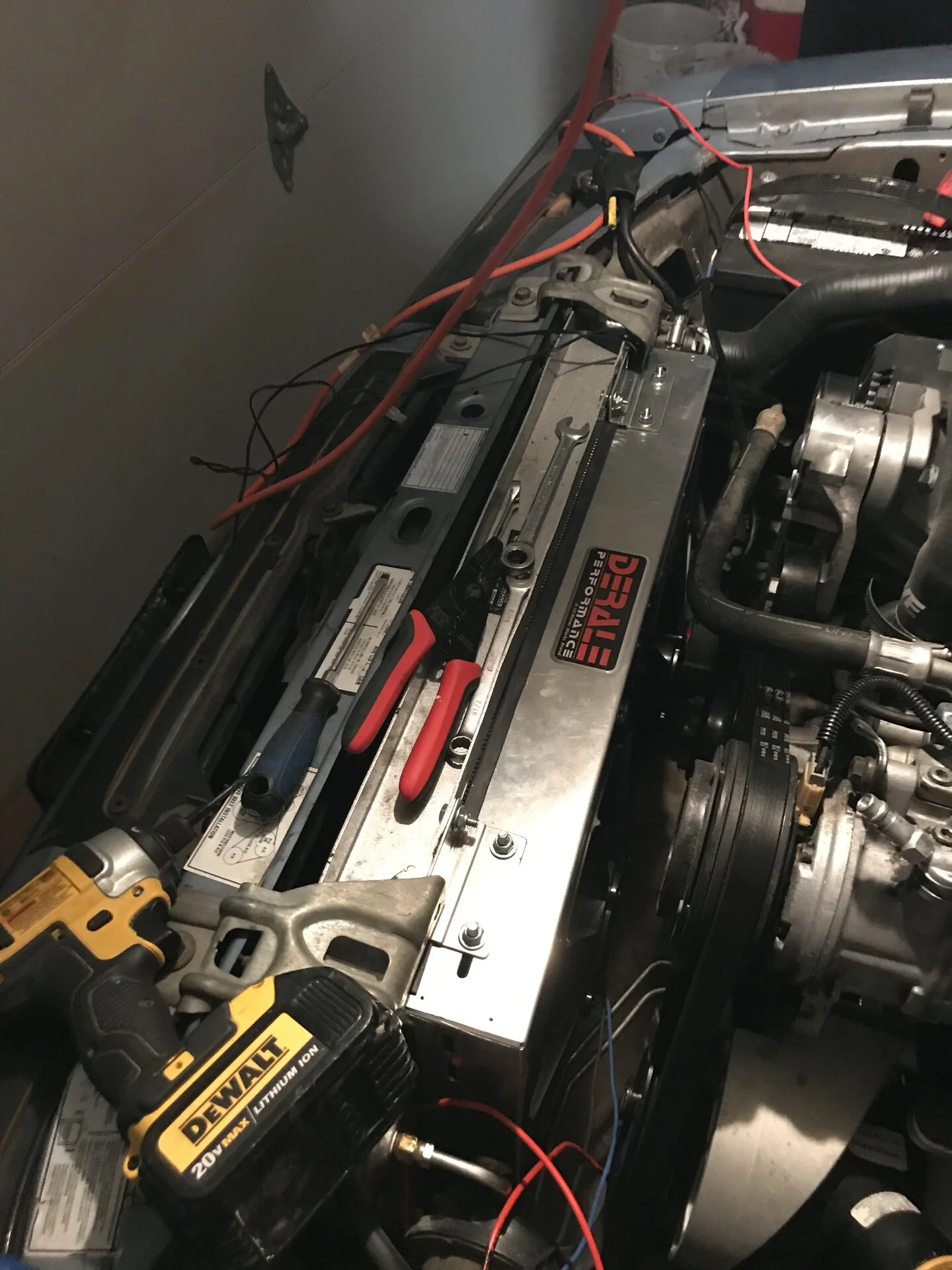

Tired of it running too warm when I turned on the air conditioner.
Got rid of the sorry SVE fans and installed Derale fans that put out twice the air.
Problem solved.

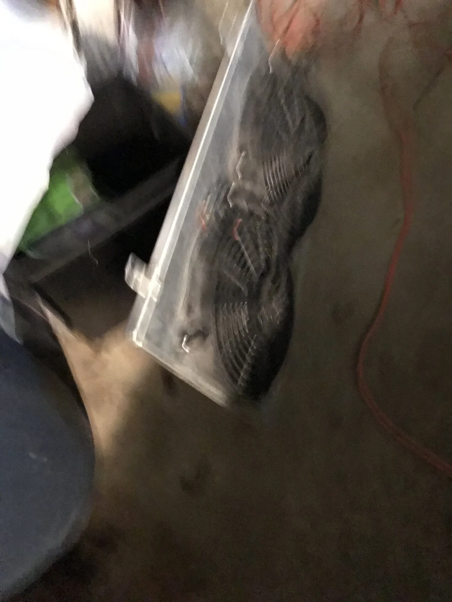

Any pics of the sorry SVE fans/shroud and new Derale fans/shroud before install for comparison?
I assume both sets of fans are/were controlled with same control system?
Glad it is working better now.

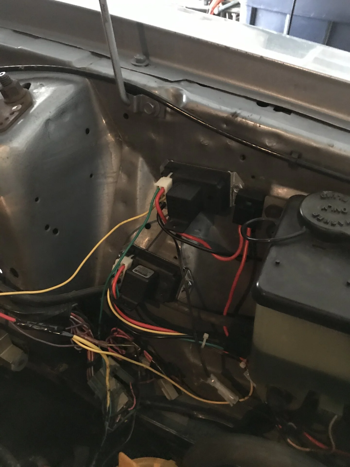

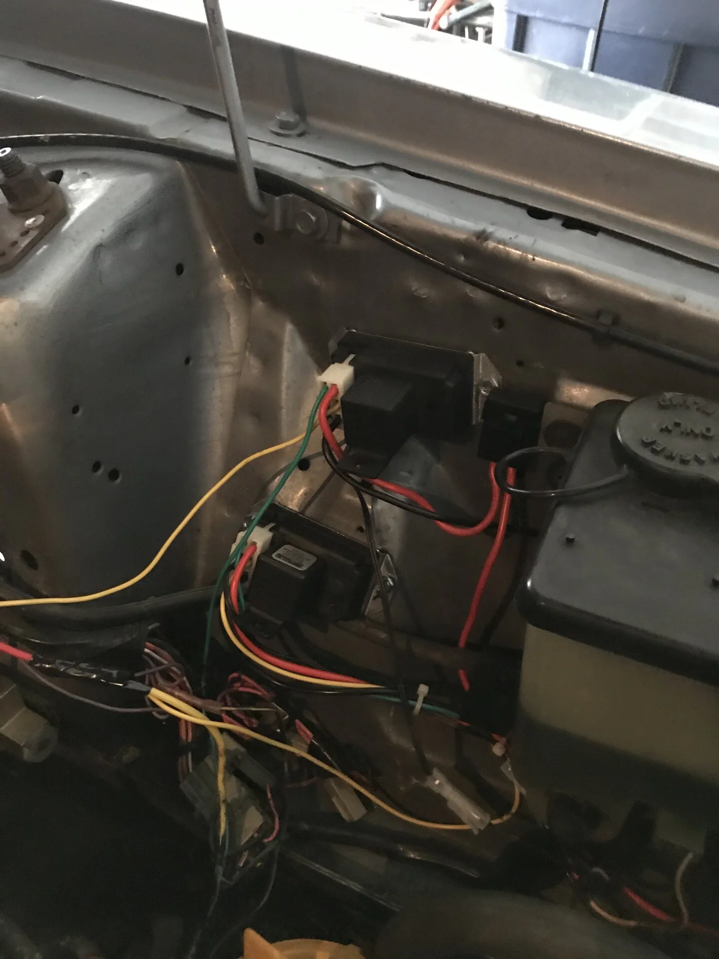

When I decided to put the 5.0 in I ordered a SVE radiator and fan kit from LMR.
The Relay that came with it quit working within a week. So I ordered a Derale relay that ran both fans.
With the new fans I wired each fan to a relay.
Works great.
Still gotta wrap wiring to make things look better under the hood.
