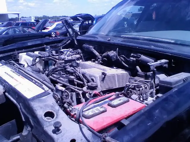

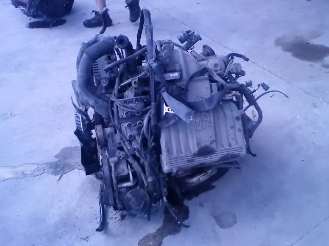

went and bought a running explorer motor today. for a damn good price.

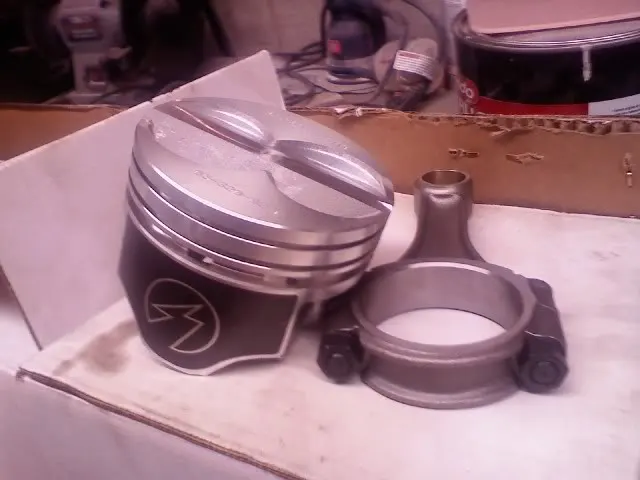

~ complete explorer motor. ( GT40P heads )
~ speed pro pistons (flat top) full floating pins with spiral locks. and a new set of forged rods with bolts with bronze bushing for the floating piston pin. all balanced.
~ rings ect for pistons

know i still have alot left to buy. gonna start yanking the explorer motor apart sometime soon. its still in the back of my truck, ill un load it in the morning and get it on the engine stand.

Very glad to see you bought a complete running motor. Thats the biggest thing i learned: Pull the whole damn thing out. I did it the hard way and swapped the top end with the engine in the car. We got it all the way down to the shortblock and i thought to myself "you know, itd be about 30 minutes more work and i could have this thing on a stand and not have to crank my back over the fenders..."

how many miles were on it? when I got my exploder motor I pulled the whole thing apart only to find that it looked immaculate inside. if it has less than 80k I would just shove the new cam in and button the rest of it back up. I wasted a lot of time and money on what was essentially a perfectly running motor to begin with.

Don't know why people waste money on forged internals when they are not gonna add huge boost or a huge hit on nitrous. That lower end will hold any HCI setup you could throw at it...and it can certainly handle it's own stock parts. Just my $0.02.
had 128 on it. but ran fine.
becasue my plan at end of the year is to add boost to it.
Stock would still hold up. MY buddy made 514RWHP on a stock 302 shortblock, 14PSI and race gas. It had 160,000 miles on the shortblock too.
Stock Mustang rods and pistons (pre-1993) are forged to begin with. The Explorer pistons are hypereutectic, which don't hold up well under a power adder. Not sure if the Explorer rods are forged or what they are. Was your buddies short block originally out of a Mustang? 514 RWHP is on the ragged edge of breaking the block itself. Sounds like fun though, haha.
I always thought the block is more of a problem than the pistons and the hypers vs the forged made almost no difference?
My understanding is forged pistons just can handle detonation better than hypereutectic pistons. If some forged pistons can handle more than 1200 hp, I'm sure hypereutectic pistons aren't too far behind. They just don't handle the heat and shock from detonation. Of course, if the tune is right, you don't have to worry much about that anyway.
