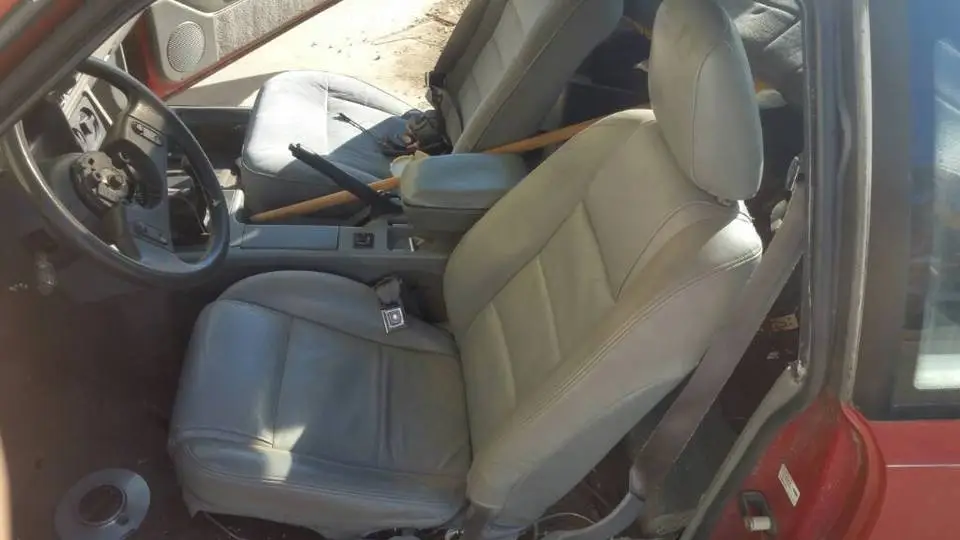

I was wondering if anybody had tried to see if the seats from the S197 will fit in a fox body and if not why. Only really asking because I have access to some from a wrecked car, and the Grey leather would match the stock grey of my fox body till I change it.
Sent from my SM-N910P using Tapatalk
Looks like I just have to drill out the studs for the original seat rails on the S197 seats and swap over the foxbody rails.
I need to drill the studs to remove the S197 rails seams easier than trying to fight a wrench in between the seat bottom foam and frame just to unbolt them.
So after about 1.5hours of work they fit (sort of).
