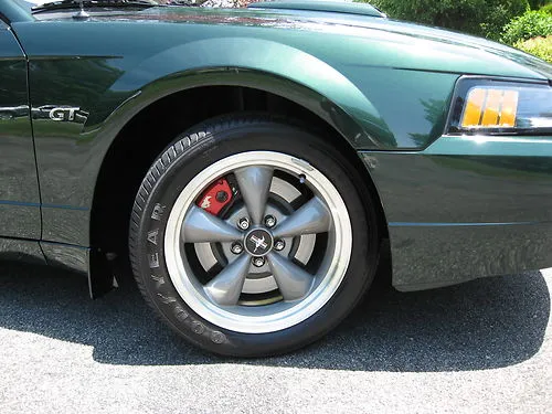

SN95 bullitt wheel

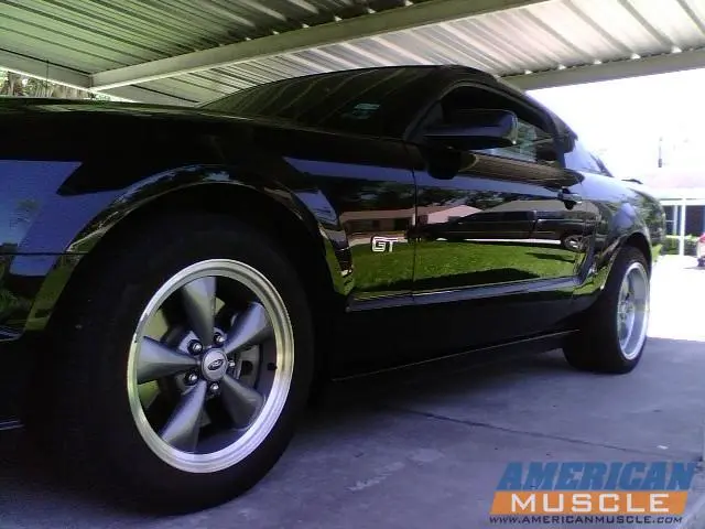

2005 17" Bullitt wheel
The main difference is where the spoke meets the lip area. The 2001-2004 bullitt wheel is more of a point, while the 2005+ 17" bullitt wheel is more rounded.

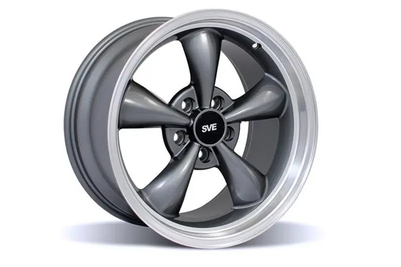

Here's a better comparision of the spoke shape
2001-2004 (these are aftermarket with deeper lip, but just pay attention to the shape of the spoke - specifically the shape of the point where it meets the wheel rim area)
2005+ 17" Take note, the hub area is a bit more pronounced than the 01-04 version, so the lugs sit deeper
