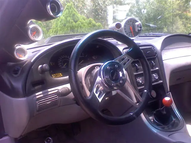

how do i tell if this car has a tune? The car pulls strong to 6200 and still not hitting the rev limiter.?
i have 2- a/f guages , one for each bank, both are running in the green until WOT, then they are running on the rich side.
If you have a chip on the J3 port of your ECU, then you have a tune. Otherwise, you can't flash the ECU, so without a chip you don't have a tune. The factory rev limiter is 6250 RPM, but if you're relying on the factory tach and it's still pulling, chances are you're somewhere in the 5500 RPM range. The factory tachometers are well known for being quite inaccurate.
HA! plenty of guages

I would post up pictures of all parts that u dont know exactly what it is. Because u aregonna buy parts that u dont need.
I know this much, that car wouldnt run well with 24s swapped in with the stock computer and stock maf. So just investigate the parts, take pictures, and figure out whats there.
Exactly. And what color are your injectors? IIRC, all of our stock meters were aluminum housed. Plastics ones came in later models, I know the lightning meter is plastic for sure and some later 4.6 meters were too.
If your maf is black plastic its not stock. What are all the mods your car has? Do you have any pics of the engine or maf?
