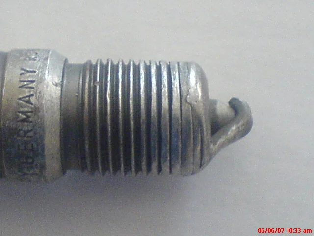

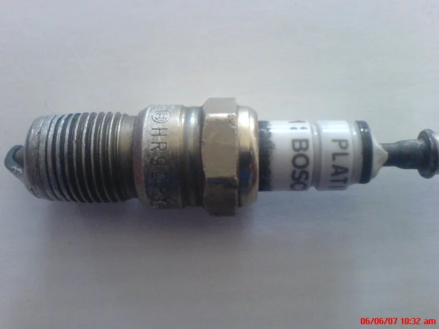

guess i spoke too soon.... drove another few miles to the store, started it again and blew the plug out of my head....AGAIN!!!!! :mad::mad::mad:
seems to be the same one as last time so i will be contacting the shop that "fixed" it in the morning....
troof. turns out it was the #3 plug, last time it was #1... so im having them re-seat all the plugs and make sure to torque them to spec. and i'll be takin it back in a few hundred miles to have them checked again.
maybe i should have them all welded in...:rolleyes:
bosch platinum, single ground electrode. the guy put in a single autolite when he replaced the first one that blew, so he will prob put another autolite in. should i have him swap them out to somethin else while he is in there?
i thought these were the later specs, i'll post a pic of the plug.
preignition will do a nice job of "smashing" the plug tip. No way the piston can contact the plug with the shroud that is cast into the head. But running lean or with excessive spark advance will do that up nicely, as will removing/blocking off the EGR.
