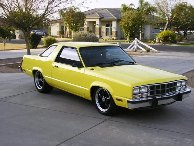

After I get it home, cleaned up, buffed, a quick 5 lug conversion and a liberal dosage of trim black, followed by the same wheels this guy is running, I expect it to look like this:

AWESOME vision!

The exterior cosmetic I linked based on the yellow car above is like falling off a log to me:
SN 95 front stuff,...cut stock front coils, w/ Ranger drums & cut coils on back w/ the right 5 lug axles cant be 500.00-700.00 totally to allow me to buy the wheels and tires to make that look happen. A slight window tint on one day, and blacked out bright work the next adds another couple hundred to the total. While I cant be sure till it gets here, the project car looks straight enough from the pics to be able to pull it off.
If I can get the car to even come close to looking like that while I modify the rest (including what I'm gonna do w/ the power train) while driving it back and forth to work will be all worth it to me.
