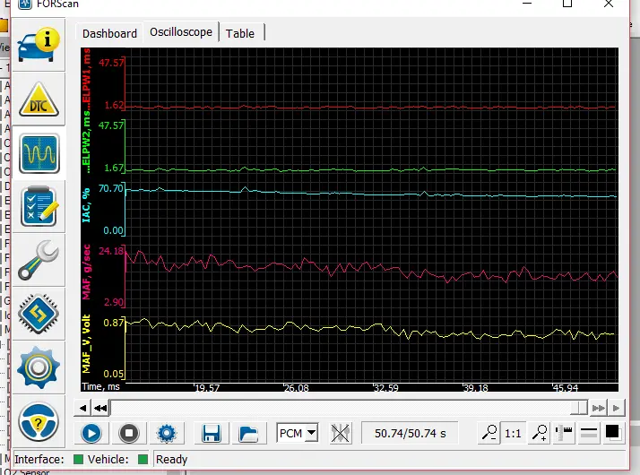

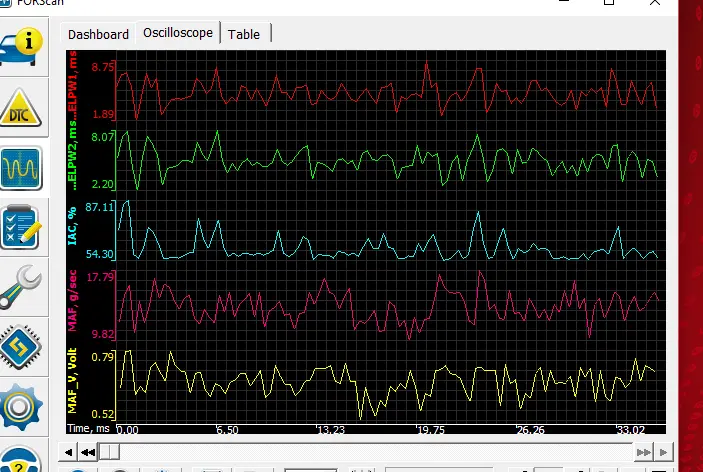

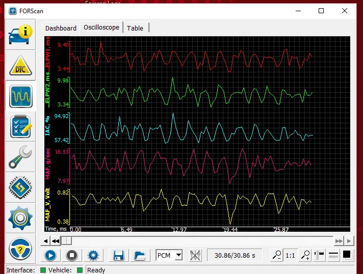

So yesterday I was adjusting the MAF table with open loop on. I read in my tuning book you would be chasing your tail unless you turned this off while you dial in your maf in closed loop. I turned off the necessary functions. I downloaded the tune and loaded to find out my idle was around 400. So I kept tuning until I got it very stable by just using the multipliers for airflow column. See the attached 4 tables from my first start and idle to my last which is dialed in pretty good.
The last two are the same tune.

So should I drive around in closed loop still to dial it in even more or turn open loop back on so the pcm will make adjustments. I feel like keeping it off is ideal until I work out all the kinks. Then we can turn it on and start adjusting if we need to.

Closed loop allows for the pcm to make adjustments. just so we dont mix up terminology but you are on the right track.
now you have it dialed in at idle but you will need to drive it to see if the curve needs tuning in the upper ranges, remember that the MAF transfer curve is exponential NOT linear so this could be very likely.
keep it up my man your doing great, just take it slow.
