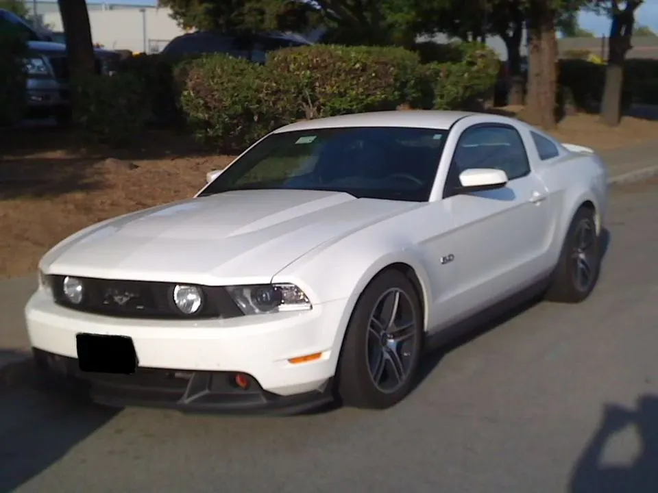

Sears Point 11-19-11 in my 2011 GT
2011 GT Brembos. Roush/KW front struts with the Roush/KW springs about 421lbs, Roush/KW Camber plates, Eibach front adjustable swaybar. The rear is the Cortex Racing Adjustable Watts link, Cortex rear Koni 30 Coilovers with 225lbs springs, and 06 22mm rear swarbar.(Just added after the Sears Point event.) J&M lower control arms, Spohn anti-squat brackets. Boss 302 oil cooler,brake lines, valance and splitter. Barton shifter and bracket. 2010 GT500 Rims 18x9.5 on Nitto 275x40x18 NT-05's
Still in the works. need more time to get it adjusted right , still working on the spring and swaybar rates. it's getting closer.. just found out the front swaybar was lose at the chassie mount so it wasn't working as it should have been.
