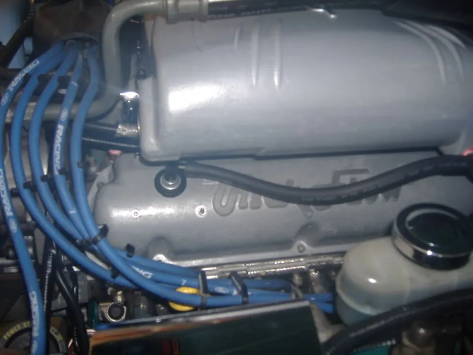

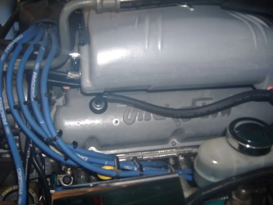

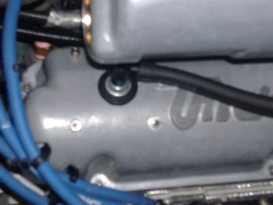

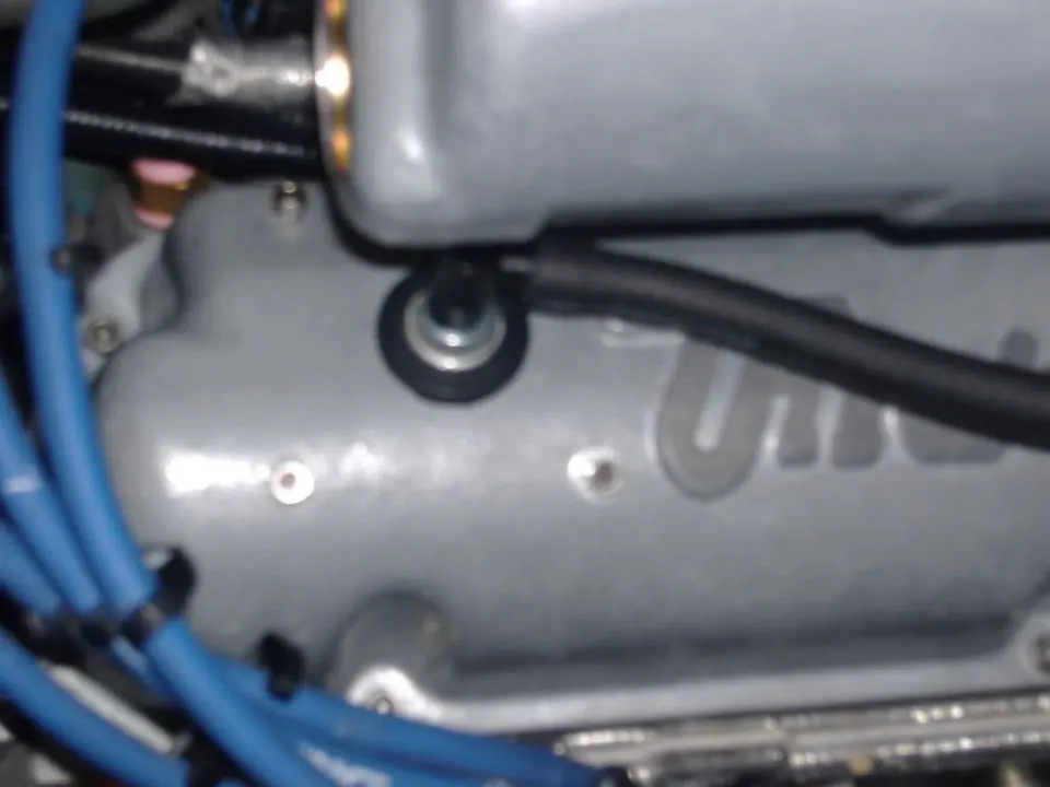

Update from previous thread, we installed the second PCV valve in the drivers side valve cover at first with no baffle. Started it up today, and it blew a bunch of smoke out the back. Drove it for a while, and it seemed ok. Then started it up at a gas station and bummer... more smoke.:mad: Used a peice of alluminum and made a baffle, and now everything seems to be good. :) Unfortunatley, we didn't take any pics of the baffle itself.:bang: Heres some pics of everything installed. A baffle is absolutley positivley a must have.
