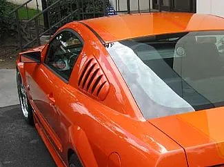

I hope these pics help. If you do elect to install the 3D Carbon spoiler, you will likely need a friend, as this spoiler must be positioned correctly the first time -- once the 3M tape (after application of the adhesion promoter) sticks, the thing is not going to move.

I used an exacto knife to carefully cut away at the 3M tape while a friend gently pulled up on the factory spoiler. 3D Carbon's spoiler fastens with the same 3M tape and covers the factory spoiler holes. I believe you wanted to know if the tape will hold the spoiler on at speed -- your question will be answered when you go to try to remove the factory spoiler -- have fun getting the tape off.:D
As for installation, this particular spoiler will flex and must be conformed to the curvature of the decklid, meaning to get it to look right pressure must be put on both ends of the center piece of the spoiler -- I do not recommend you try to do this by yourself. Your best bet is to let the body shop you choose to do the painting do the ducktail install.

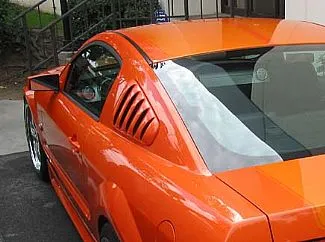

I have the SS Gen2 louvers. I purchased them pre-painted (from SS on Ebay). The install was pretty easy. You're provided a small roll of 3M double-sided tape, and some adheasive promotor.
I cut the 3M tape into little sections and placed it on the louvers as needed. I was careful to leave a small opening between the tape strips which allows water to drain away (rain, car washing, etc.).
Also, I masked all the finished/painted areas of the louvers, and painted the inside areas flat black. It looks 100% better from inside the car. I went to the store and bought a small can of flat black model paint.
::Installation::
1) Make sure you have the correct louver for each window. They're shaped a little different, if I recall.
2) Clean the windows with some Dish soap to remove dirt, wax, etc. Dry well.
3) Remove the stickers from the 3M tape, line it up, and press along the edges.
Done. Takes about fifteen minutes, and $4-5 for the can of flat black.
