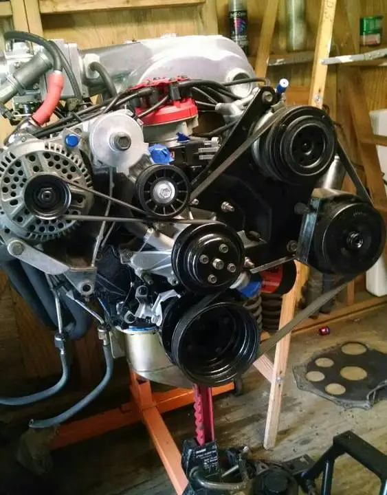

So what if you're running AC and PS with no smog ?...that's how I run mine but belts been on for six years....numbers worn off belt. I'll try to take it off and measure tomorrow for you.
The belt is already stretched....it started out with about a half an inch gap between the tensioner 6 yrs ago. The pick makes it look weird but its got about a quarter inch now. When running it opens up to about a half inch. I live in Maryland and this belt has carried me through several trips to myrtle beach, SC and into Alabama and Georgia. No problems at all.

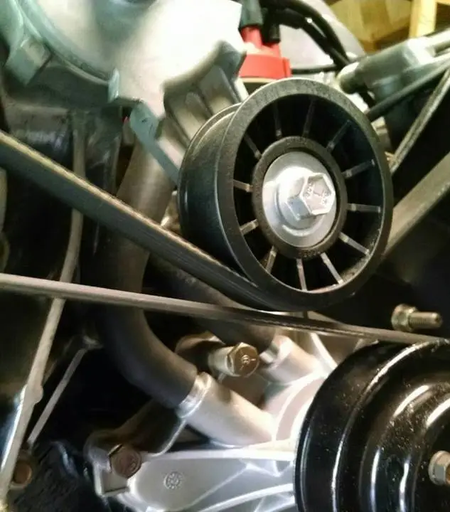

I must admit squeak93 the diagram with 84.5 belt looks like a better routing. However, through trial and error my current belt routing hasn't had any issues. Under load the belt pulls the tensioner more widening the belt gap. There has been no contact of the belt. The pic is of my new 331... I ran the same belt on my previous 347...and the 302 before that. I may be just lucky. ;shrug Hopefully that spot where the belt would run past the smog pump will be occupied by something else....putting the belt right in the way.
Here's some pics of my belt routing. Its a 770k6 6pk1955...has been working well...no belt contact at tensioner.
belt is one the wrong side of the H2O pump if it is a reverse rotation fox body pump. Belt should go from the alt down to the crank, then around the passenger side of the H2O pump, down around the PS pump, up around the A/C clutch, under the tensioner, then back around the alternator. 83 /12 to 84 1/2 inch belt.

The water pump pulley should spin in the same reverse-rotation direction regardless of which way the belt it wrapped around the pulley so long as the non-ribbed side is against it.
But I will say that it would be better to run the belt as you describe. That's pretty much the same way I run the belt in my '95 with a deleted smog pump; the only difference being the location of the power steering pump and A/C compressor.

Look at his picture and tell me which side of the H2O pump pulley the ribbed side of the belt is pulling the pulley..
The smooth side is on the wp pulley. Like I said its been like this for 6yrs.... About 30,000 miles on different motor combos...on the street and the track...taking nitrous hits and all. No problems.
Sorry guys.... I fixed my belt issues and forgot to follow up. I routed my belt just like 90sickfox's picture and went through 2 belts in a month. I bought the 84.5 belt and routed it that way and no more issues. Thanks everyone. I don't know how 90sickfox's setup works and mine obviously didn't.
