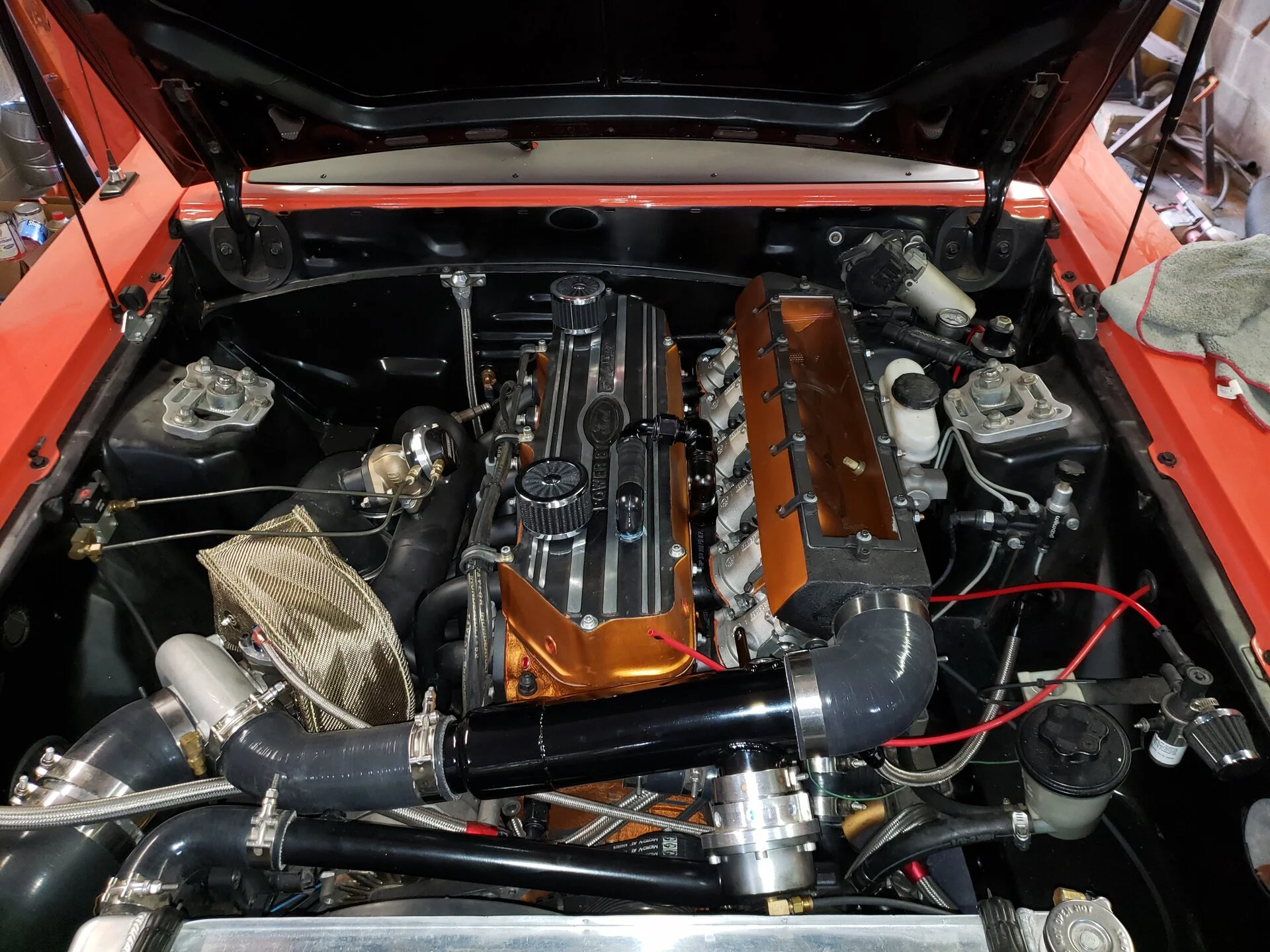

But you never know…with enough stupidity….The Maverick engine bay can still look like this:
Behold the Lowly Maverick 250, with a little help from Ford Australia, and some crafty repurposing of a few BMW throttle bodies.

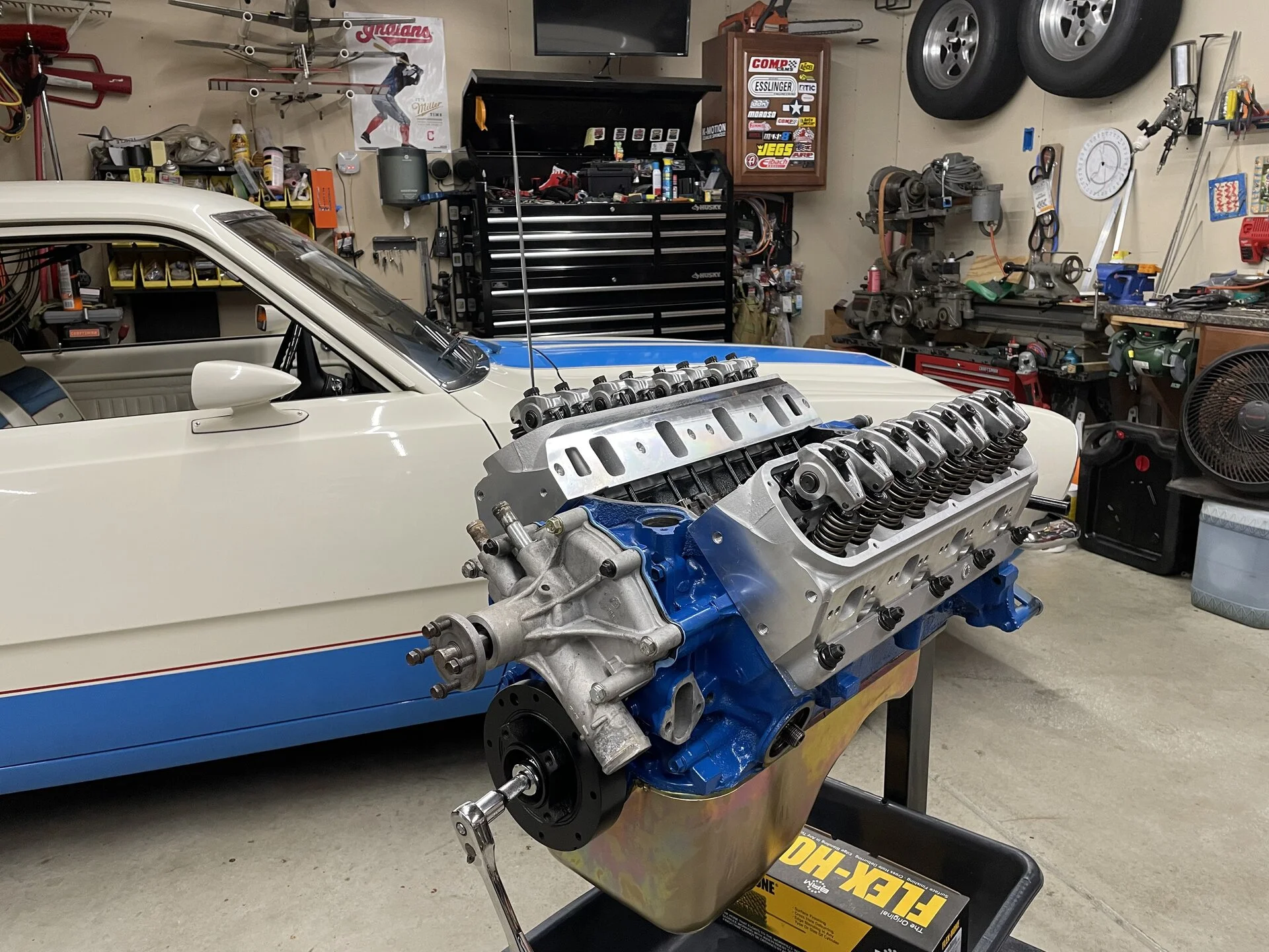

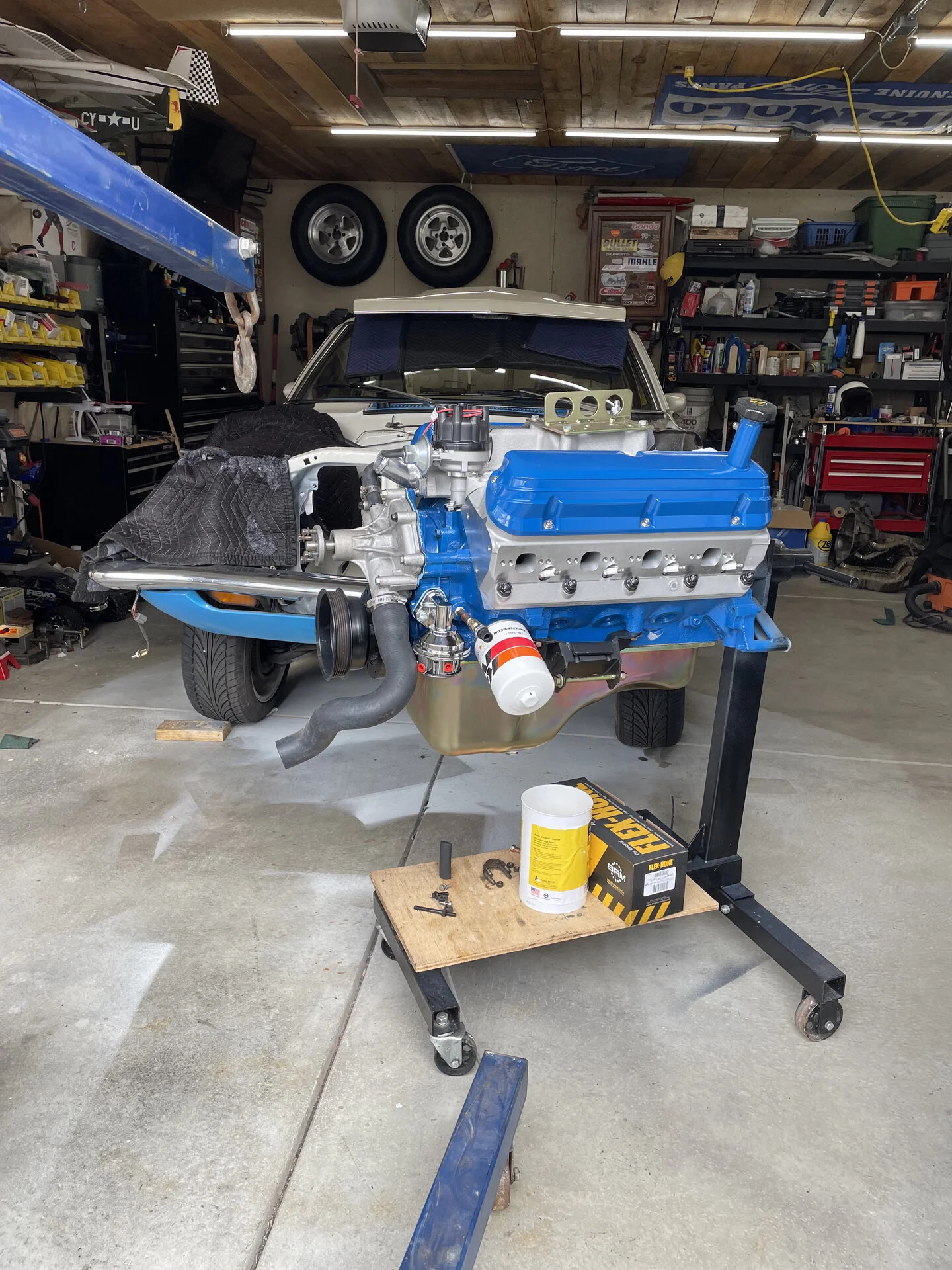

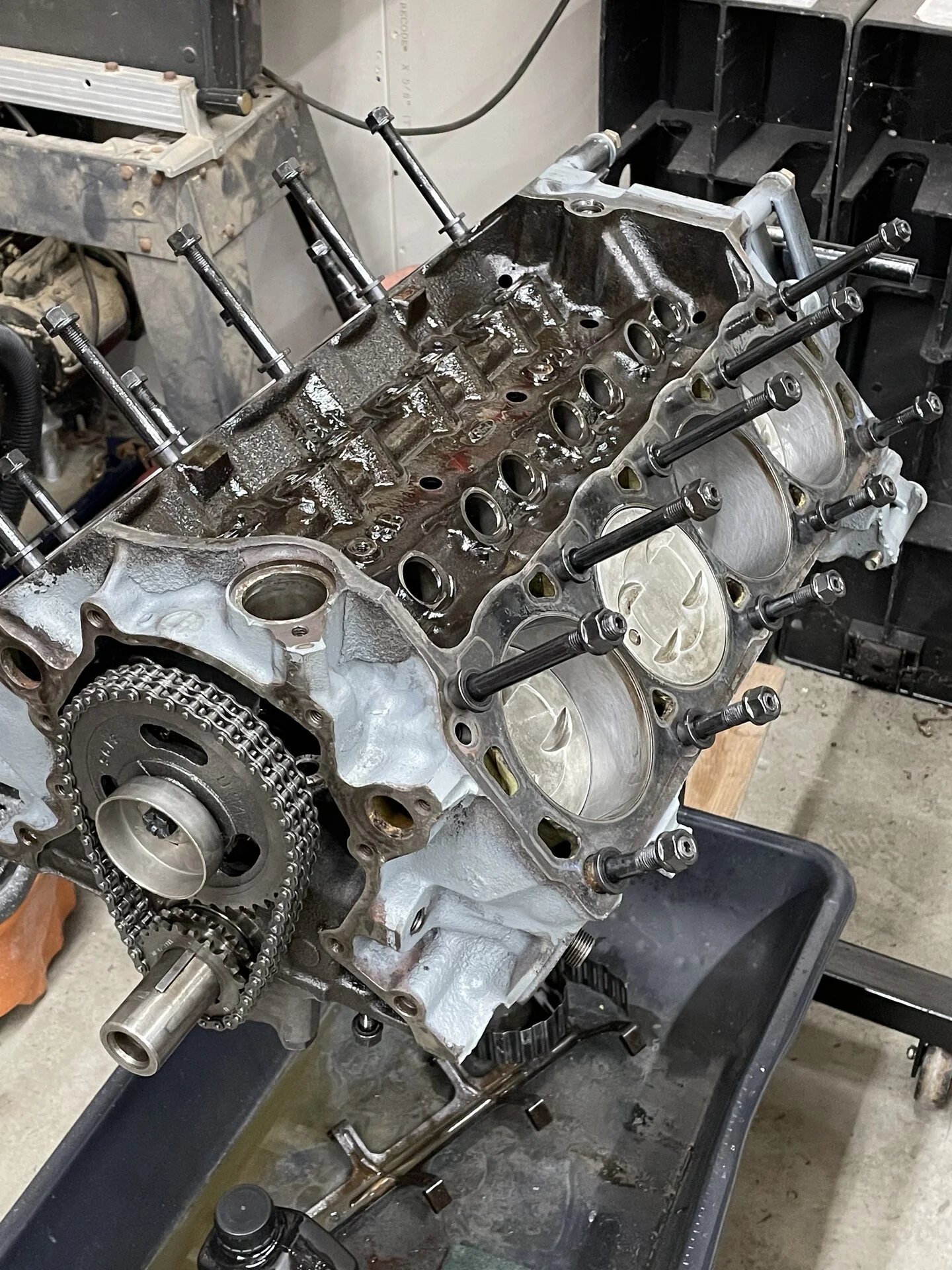

Made some progress on my old 5.0 honed the cylinders and got the rotating assembly installed.

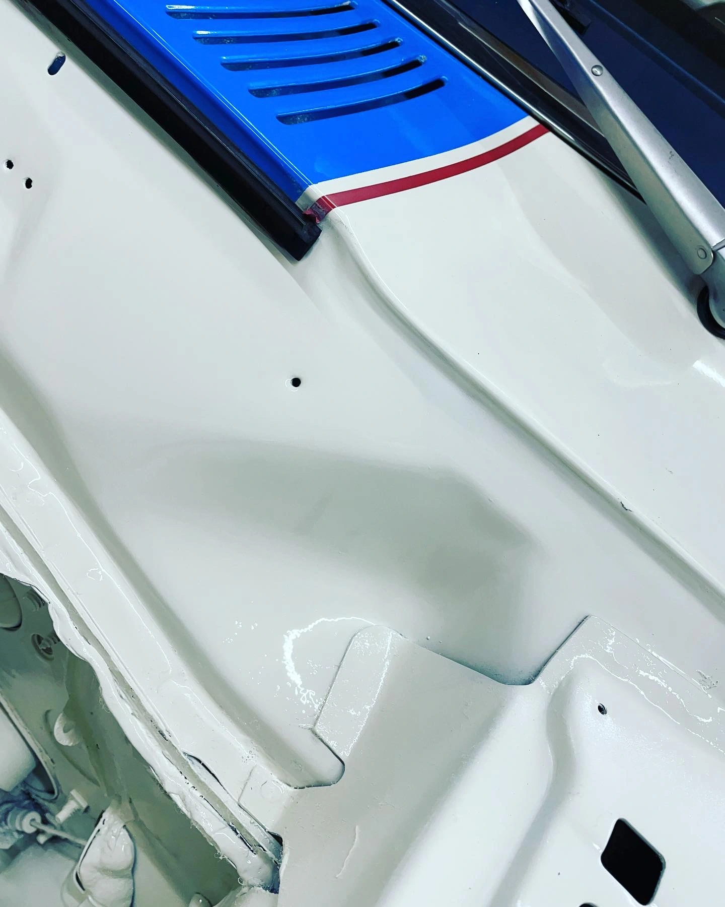

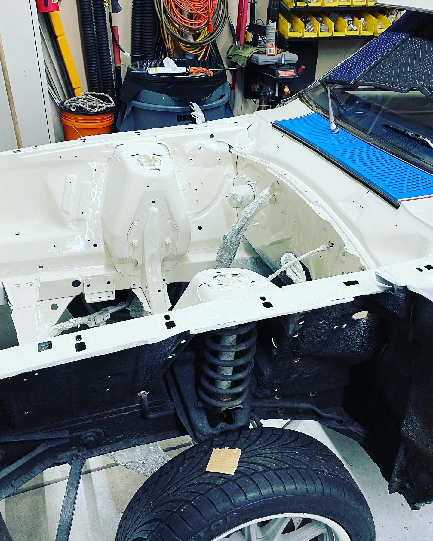

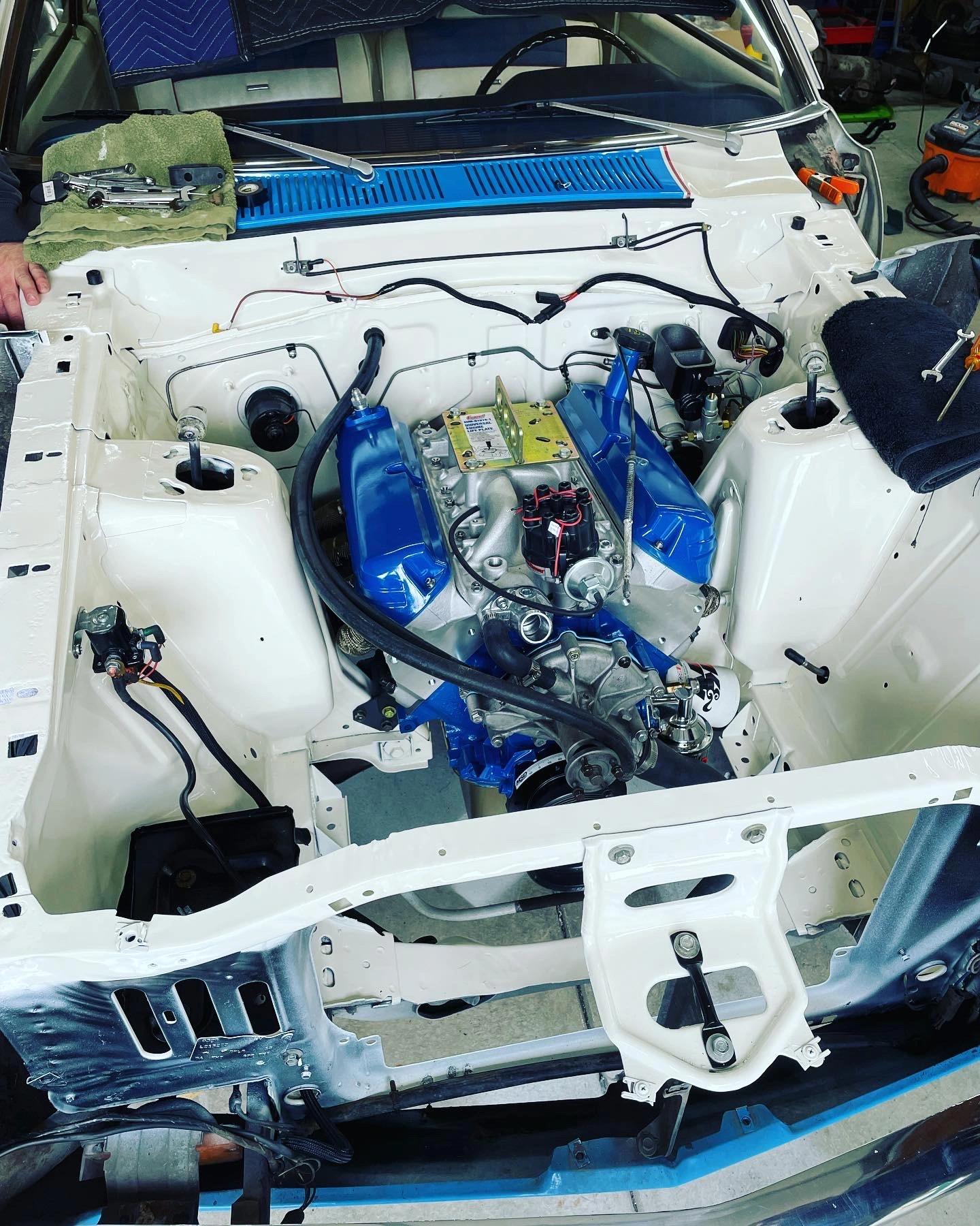

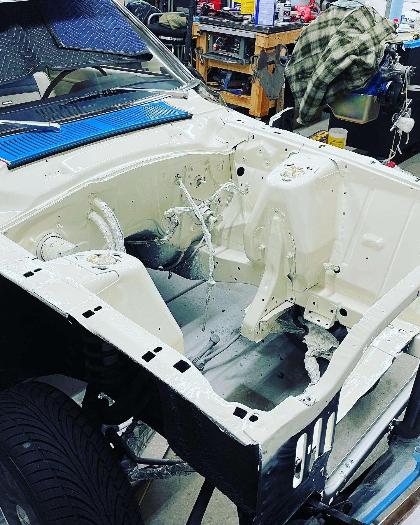

Another “not” foxbody post. I repainted the engine bay on my Maverick and got the old 302 from my 87 installed. (A little foxbody I guess) still need to cut hole for floor shifter and pull the diff and have my brother set it up with the 3:55 gears and Yukon limited slip.

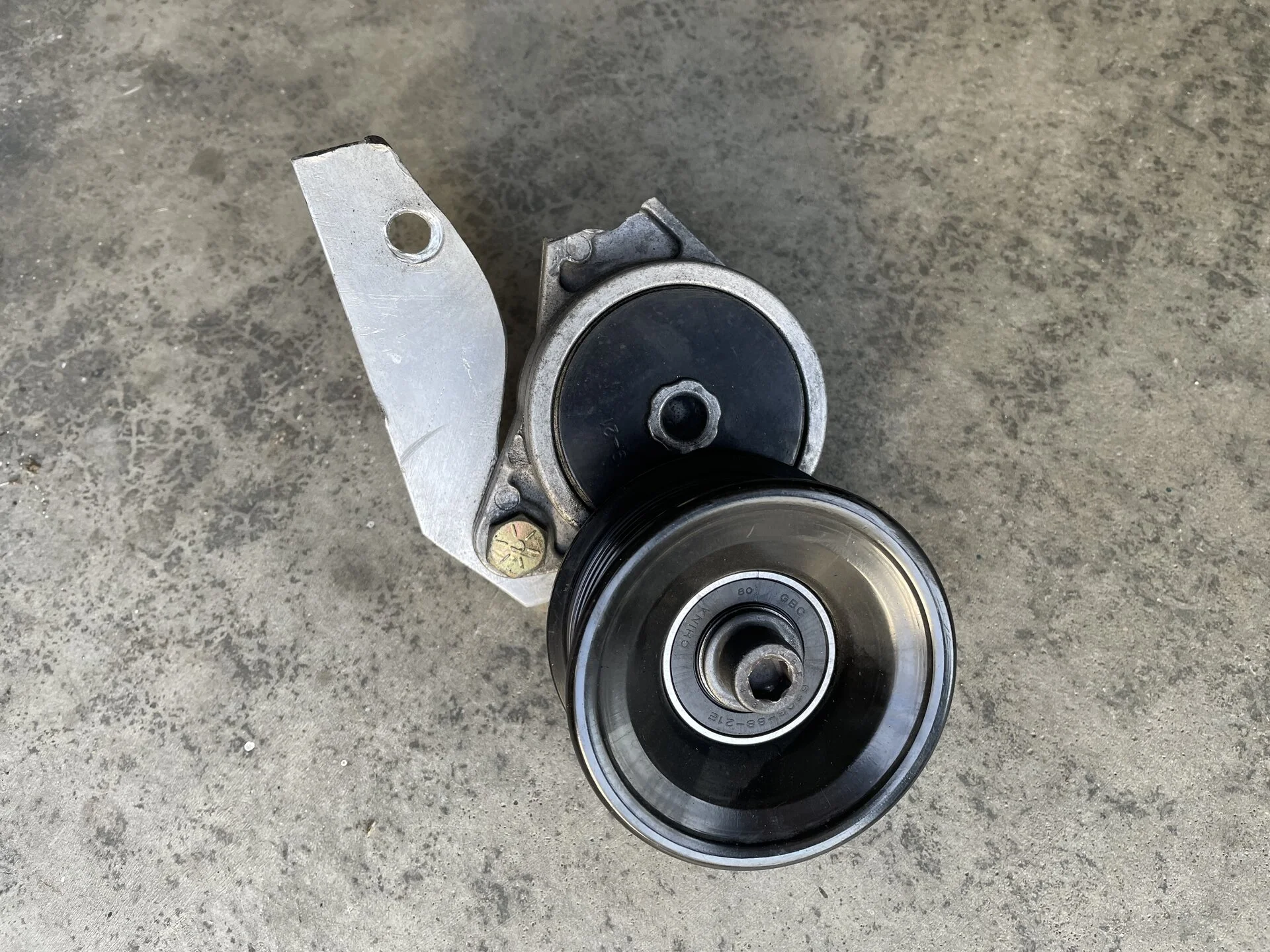

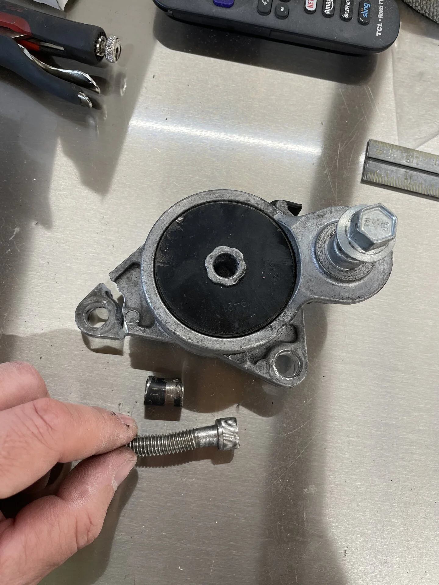

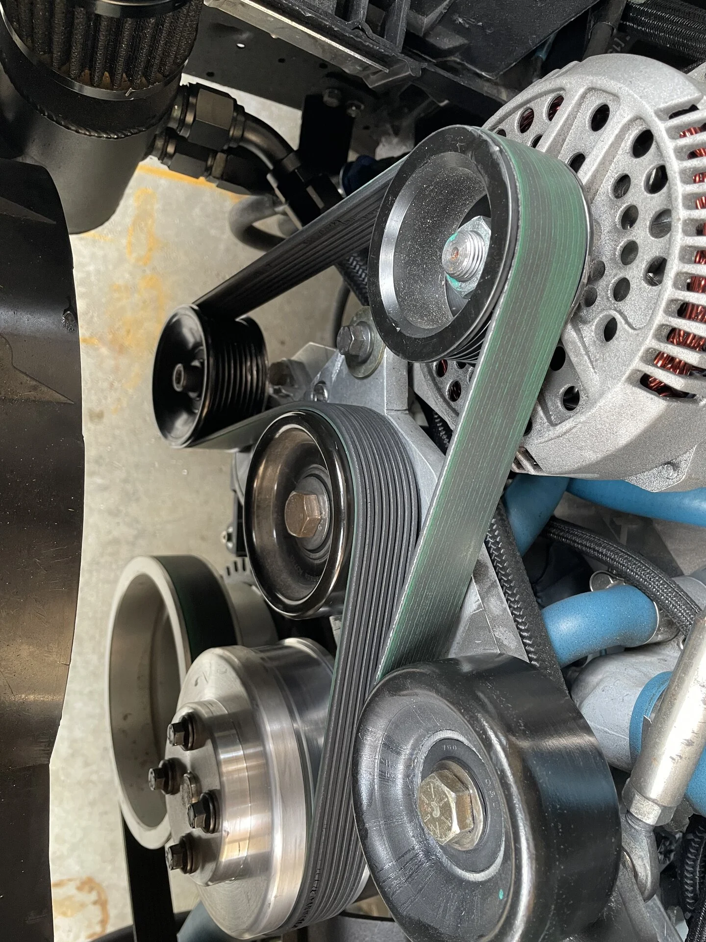

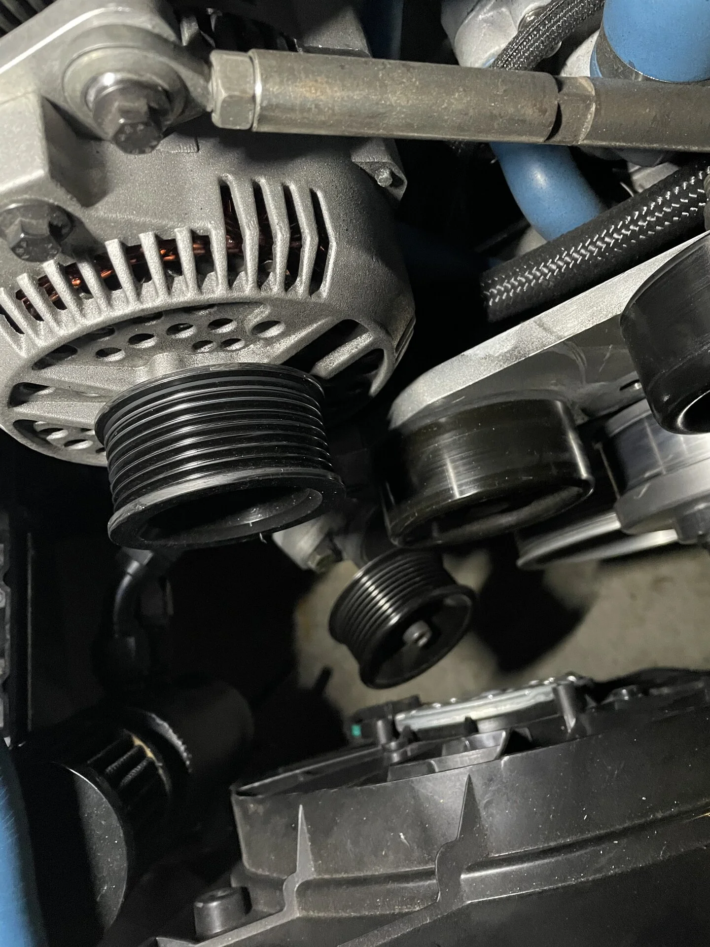

Well the good weather has arrived here in northeast Ohio. Car is running great but I broke it! So I was backing out of my driveway and my foot slipped causing the car to jerk hard a couple times. When that happened a couple things happened. The engine rotated in the k member, belt popped off and wedged itself in the water pump pulley and then tried to rip the tensioner off. So I had to loosen mounts and jack up one side of the engine to straighten it out. Had to replace the tensioner and pulley and need a belt. Was able to get it back together without too much trouble. Now I’m thinking I need something to secure the engine so it doesn’t try to slip in the slots on the k member. I could see wheel hop causing this in the future so I may tie the engine to the frame.
I find it odd that the engine would/could move around that much that didn't involve a engine mount failure.
In the 'old days' we put a chain on one side of the engine to keep from ripping the mount apart but that was when the mounts were 3 pieces with no safety.
I tend to agree but the mounts seem fine. Perhaps the nut on the stud that goes through the K wasn't sufficiently tight or got somewhat loose? The mounts were new. I'm either going to tie it to the frame or make an insert to fill the gap in the slot that's in the K to prevent slippage.
Reactions: a91what
I think that is the first time I have ever seen or heard of an engine twisting in the mount. :shrug:
I mean... I could see if the bolts were loose? Even broken mounts still have the bolts and top plate still glued to the engine. Weird :hide:
