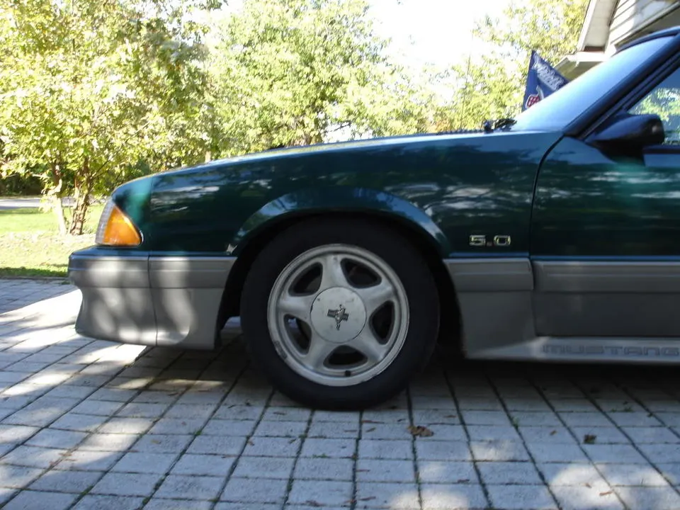

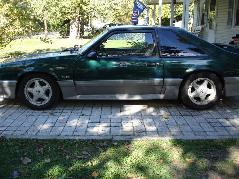

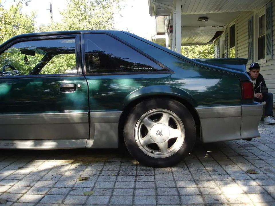

I have Steeda sport springs with stock OEM fox body struts and shocks. HPM Mega Bite Jr's LCA's mounted on the top bolt hole location. The rear was 1 inch lower on the bottom hole, but I had to raise it because the car would bottom out. There is also two 1/4" hardened spacers between the rear perch and the spring.

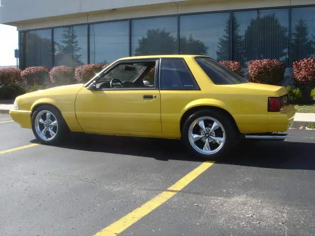

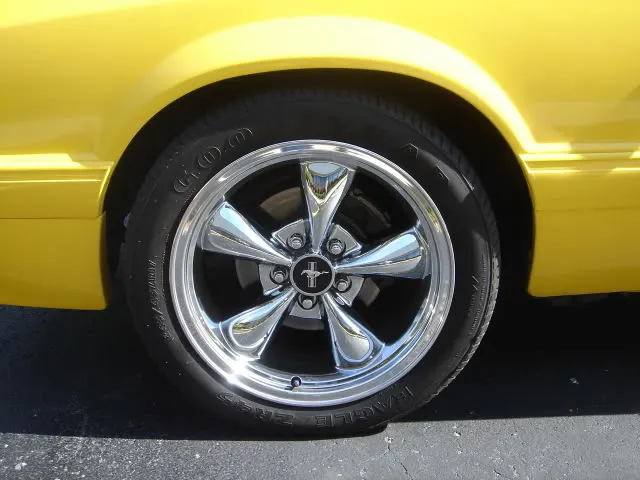

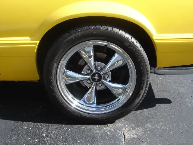

I have H&R Sport springs with Bilstein shocks and ajustable rear control arms. The height looks similar to the yellow car above. I like the height and look very much and the ride feels good. It may be a little stiff for a daily driver though. If I had to do it again I think I would have gone with coilovers in the front. The kits are really not that expensive any more and if it is a daily driver you can adjust the height when you need to. I think I may switch in the near future.
That looks good also.
