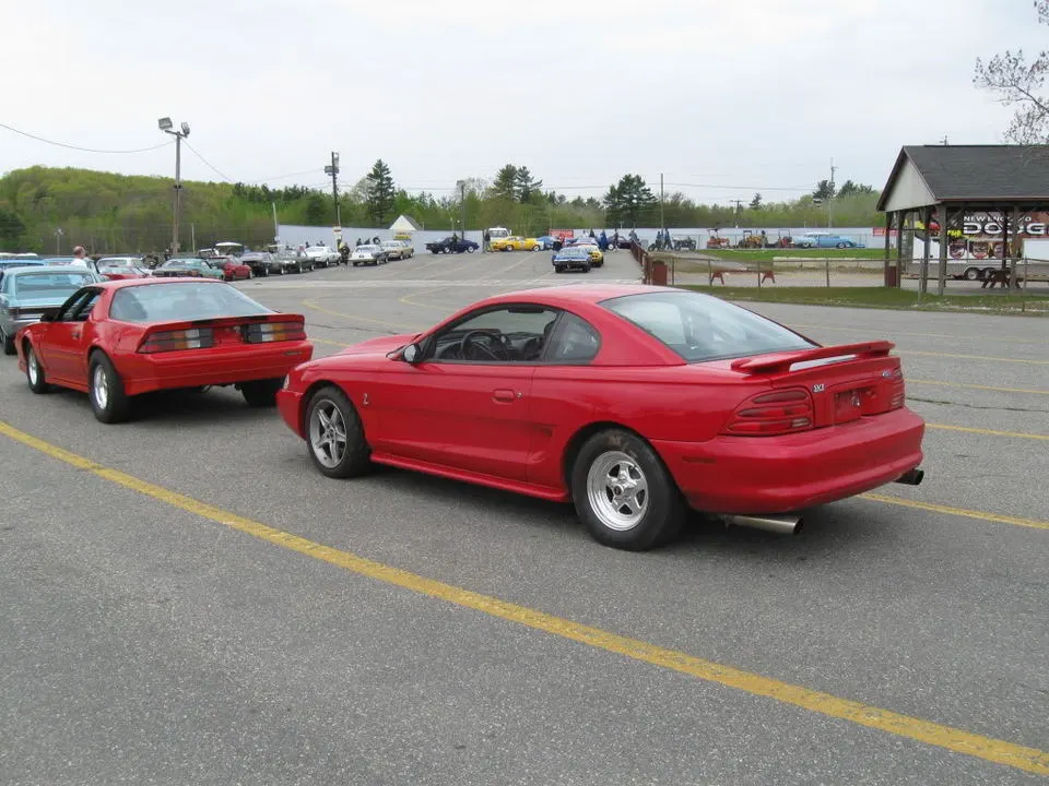

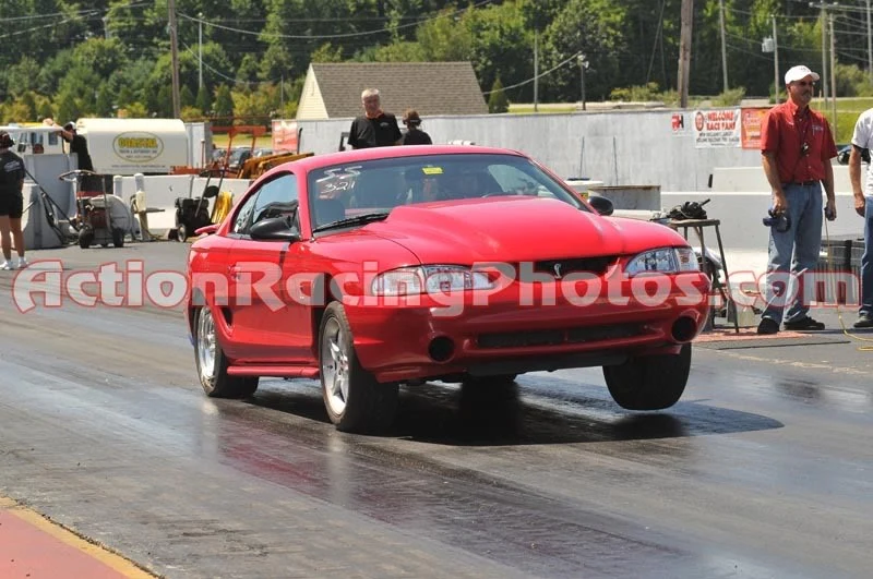

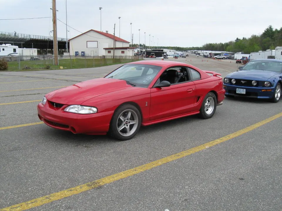

Here are a few track pics and what taking some weight off the front end can do even while still running stock size rims.
