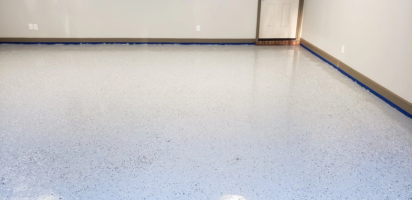

I'm in the process of building a shop. It's up at this point, but I've still.got a lot of work to do before it is useable. One of the first things I've got to do is, want to do, coat the floor. I bought a product from Armor Poxy called ArmorPoxy ll in Ford racing blue. I was not going to put flecks in it. However, as it turns out the concrete has fiberglass in it. No big deal. Except there are fibers sticking up all over the place. You dont see it at first but when you start really looking its hairier than my legs! I just put a similar product down in the garage and noticed how much the coating brings out the fibers. Now I'm thinking I need to put a fleck down to hide the fibers.
Given the situation if you were coating your shop floor Ford Blue what color flecks would you pick? I'm terrible at picking colors like this. The wife has suggest white and grey. No @Davedacarpainter I won't be putting green flecks into it. I'm attaching the fleck chart and a pick of the garage floor so you know what I'm talking about. Its gonna be a while before I do this but I need to order this stuff if I'm going this route.

If it were me....I'd go with the fleck closest to Ford gray you could get. Right now my shop is Ford gray walls with Ford blue trim and I like the colors together like that.
My garage is white, gray epoxy floor, I have the fiber crete also but I had it trowel finished, just finished etching the floor and will be applying the coating likely tomorrow. It's the last step before moving in.

Red and White. Not a bad idea. Ive got to look into the brick thing. It would be a lot of floor to brick though. Maybe the sander would work better. I really want it to just be one nice smooth solid color.
I contacted the guys at Armorpoxy about preparing the floor. They said to use a brush torch to burn off the hairs! Maybe I'll break out the flamethrower after all. I'm going to have to prime the floor though.
The one thing to remember about concrete, I think it's the lime, but too must heat will make it pop out little pieces and they are HOT. Just fan the flame over the surface like your painting a car not burning down a tree!
LOL. Hear ya loud and clear. If I do go through with the burn route it will be quick passes. All jokes aside I think it is the best route. It's a fresh pour so any trapped moisture, if super heated, with a crazed flamethrower would definitely make it pop.
