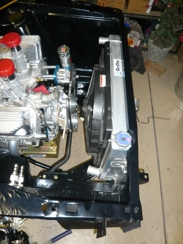

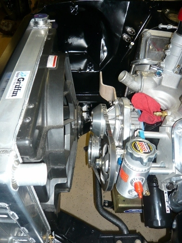

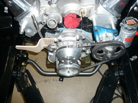

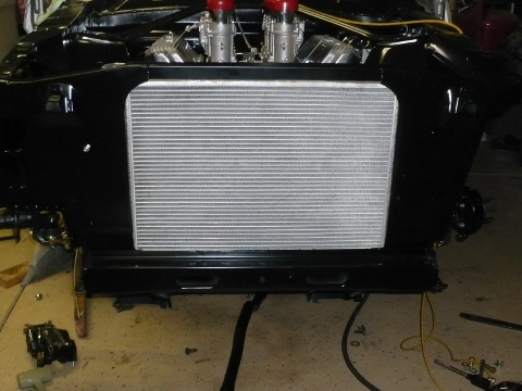

Another option you can go with is a shorter water pump setup made by a place called Snow White out of Fresno CA. I have installed one in my 1965 FB with a 351 along with a large radiator and a Lincoln MkVII fan that is quite thick, I was able to fit the radiator and fan which measure about 8 1/2" thick.
Mtaqua
I installed the Snow White water pump, here are a couple of pictures, I have not got everything finished yet but am getting closer. Snow White offers pulleys for their pump, I am using their pulleys but have modified things a bit as I want to run a custom power steering pump and am mounting the alternator differently as well (you can see my wooden mockup for an alternator bracket in the pics.) I cut down the Mark VIII fan shroud about 3/4" or so and notched my radiator support along with making the opening larger to fit the radiator. I had already modified my radiator support by making the top portion out of 1 1/4 square tubing in place of the folded edge to help support things before I cut it for the larger opening. I have over 1" of clearance from the water pump pulley to the fan, not a lot, but enough. Good luck.
