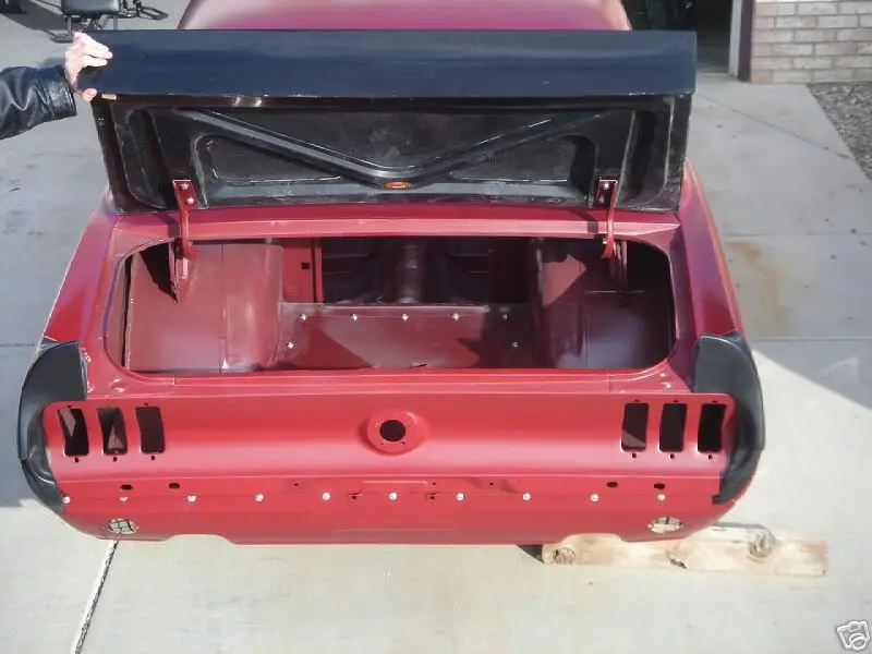

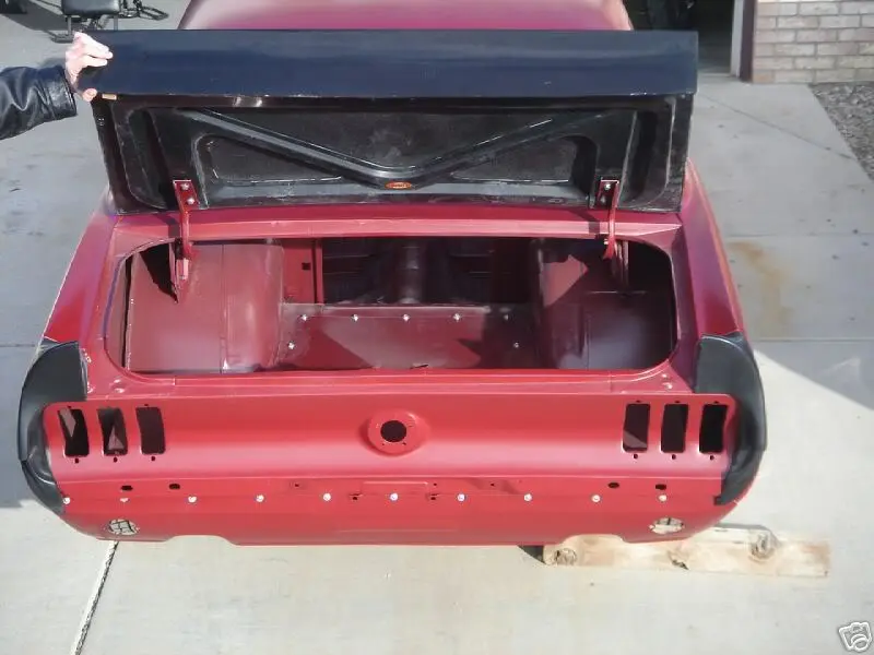

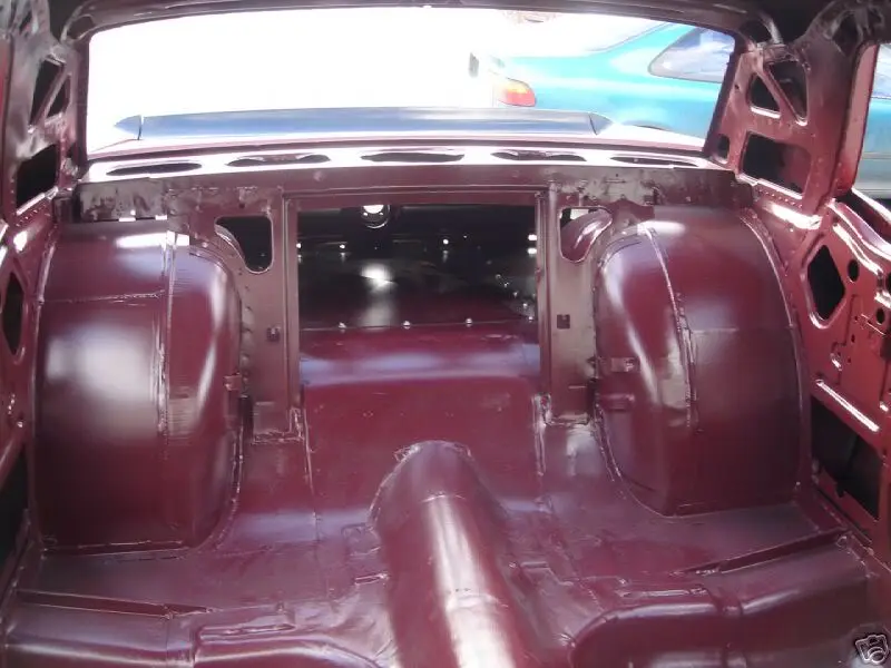

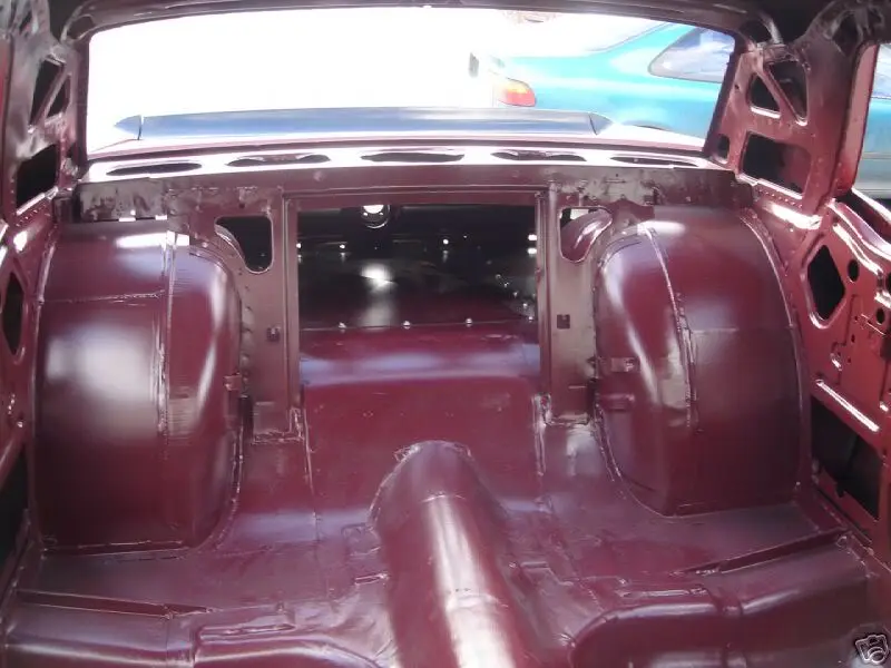

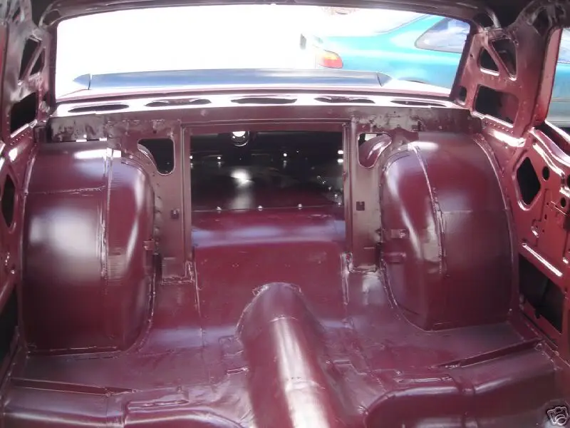

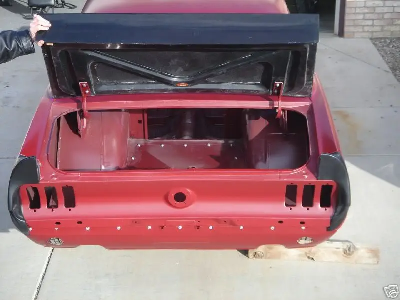

This is an example of a mini-tub with a factory look...
looks sweet. what size wheel wells are those?
check out darknights ride. that thing is fricken sweet. big tires out back make me drool
