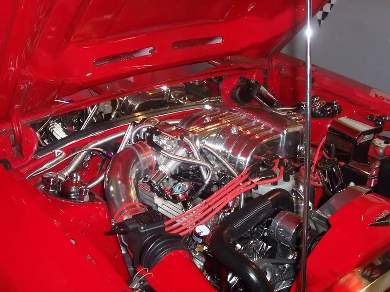

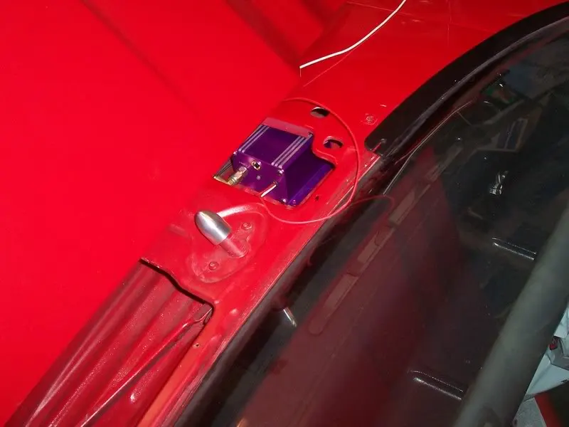

well no trunk pics available..just mounted it passenger side oposite my bazooka tube in the hatch area. As for the 'brains' of the kit...zex dry kit installed in cowl...
only lines in the bay are spray nozzle...

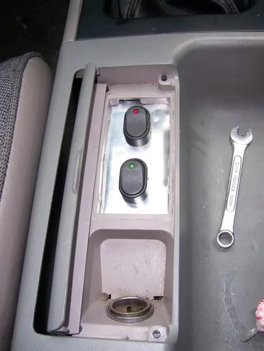

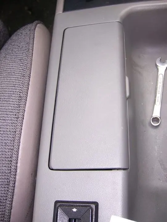

I fabbed a switch panel up myself using walmart switches, total cost...4 dollars:D
Basically it is scrap aluminum(left from an old A9M that crapped out on me), polished it, drilled 2 1/2" holes and screwed the switches in. Removed the ashtray and mounted it lower, onto the tabs that are in the ash tray's hole so that the switches would clear the door. Now I have hidden switches... I took these pics right when I made the panel, so I still don't have pics of the setup in the car... damn bodyshop taking forever with my damn quarter panel :(
