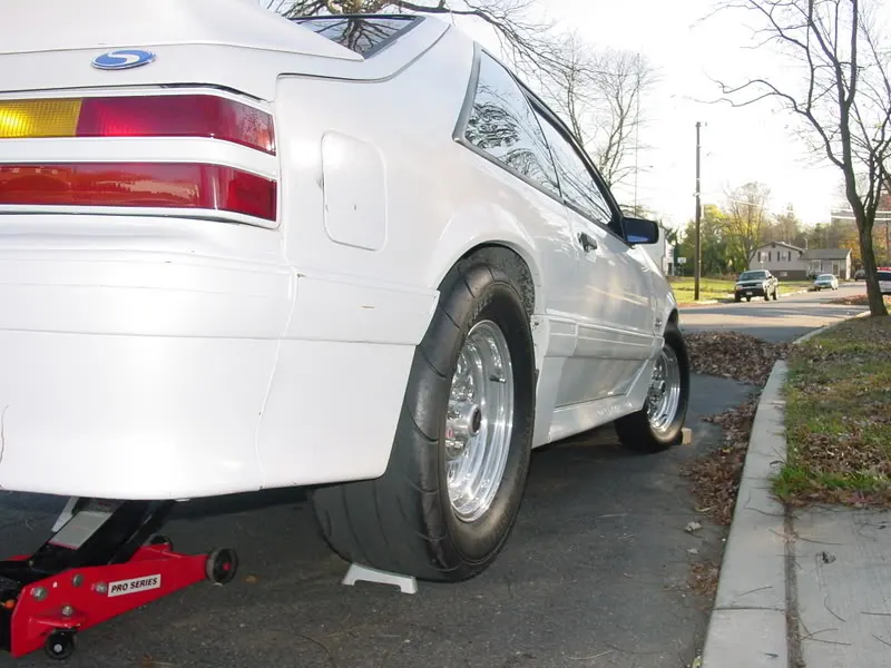

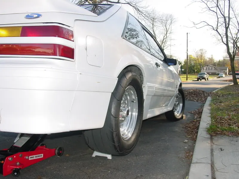

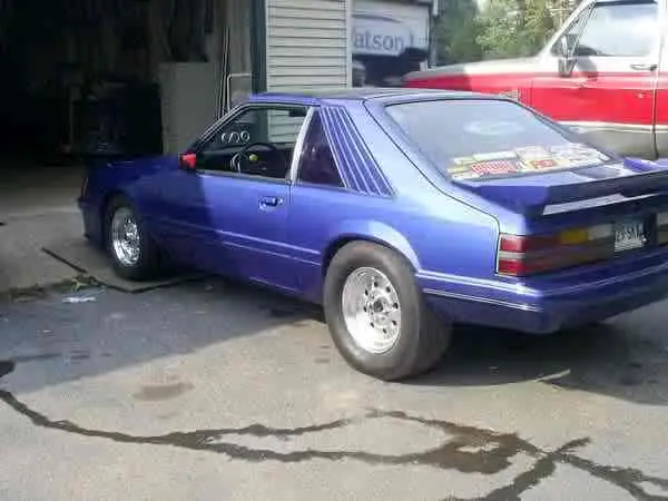

My 85 28X11.5X15 Mickey Thompsan et streets

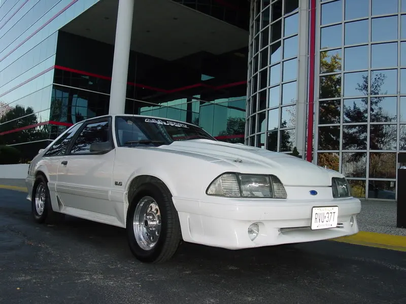

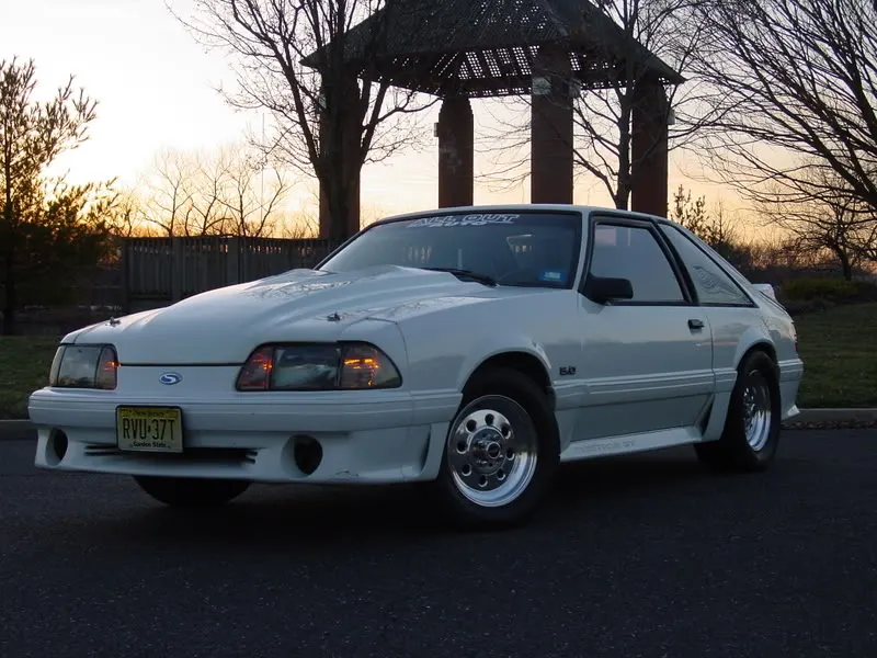

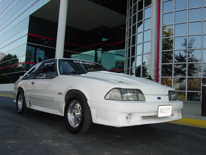

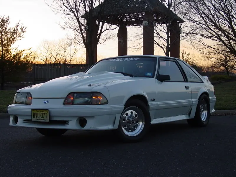

here's some old pics of her, tires are 275 50 R15,biggest you can fit on a gt without cutting,i had to hammer the wheel wells
