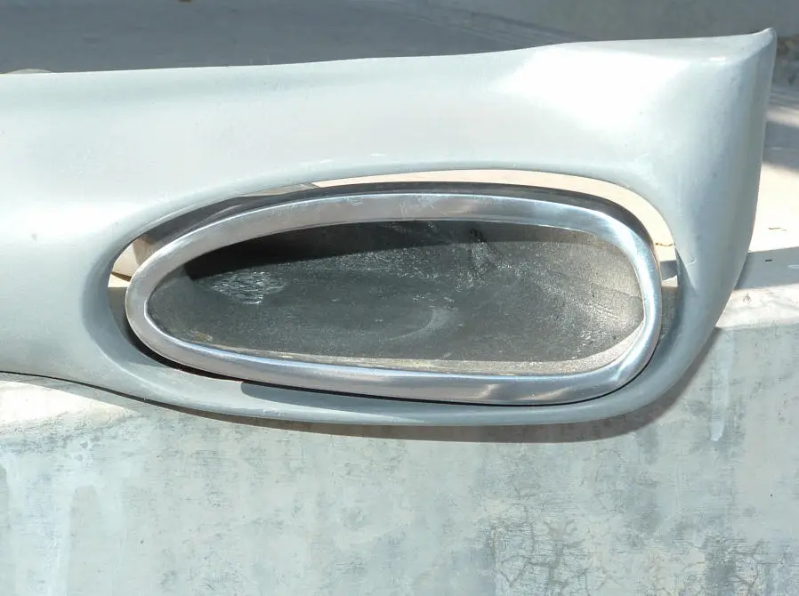

How are those tips going to look with the roush style opening? I've never seen those 2 together.

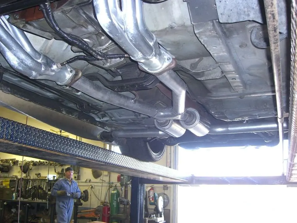

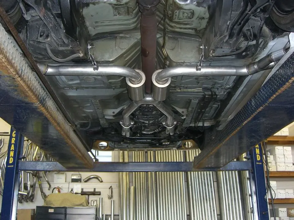

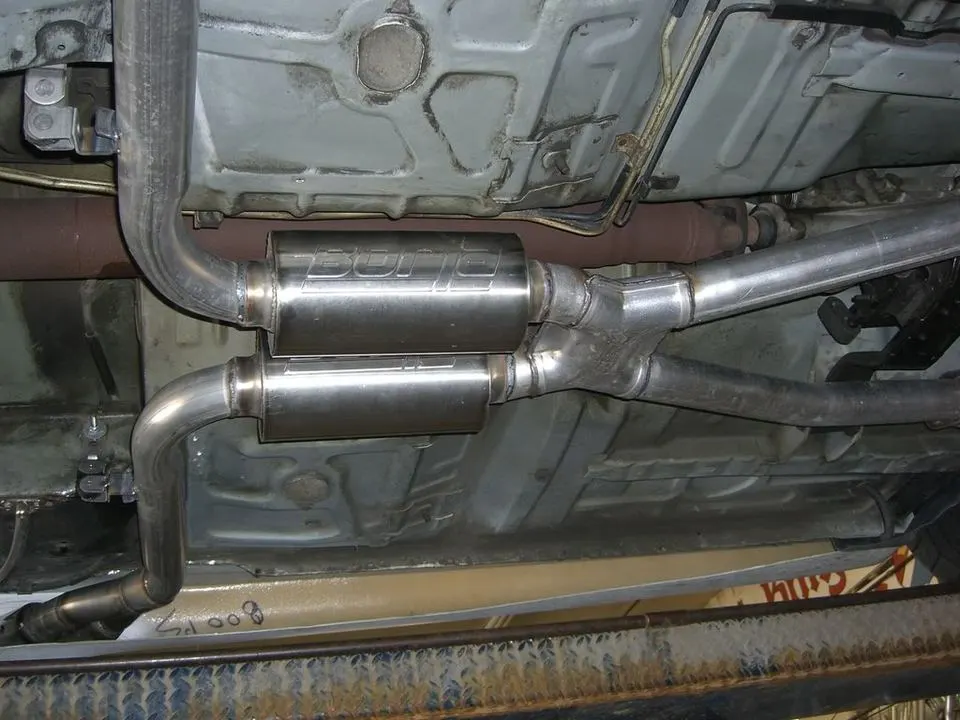

Here are some shots to get some ideas flowing...
Cobra R:
TurboGT:
Random:

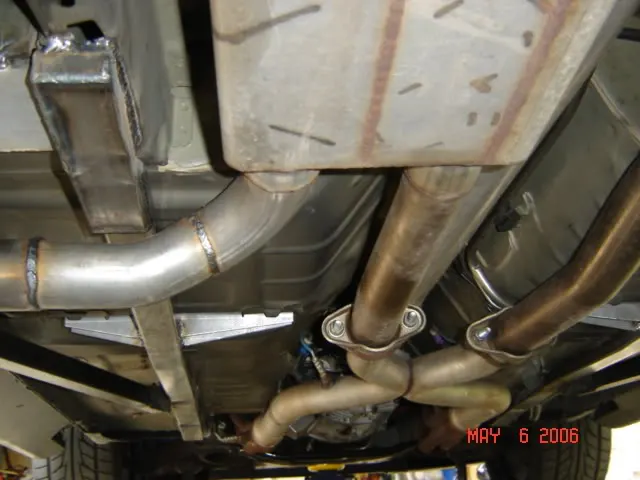

I don't know how anything could be much louder than my stingers.. honestly...
Yes, at idle, they are quite a bit quieter than it was with open headers, but mid-throttle to WOT its basically just as loud as open headers...
The same side inlet/outlet is obviously the easiest way to package the deal, but I REALLY didn't want to have those sharp bends in there... I plan to make considerably more power in the future and just didn't like the idea..
4" diameter mufflers would be great, so they could be tucked 1/2" higher into the driveshaft tunnel.. I drag my mufflers when I pull into alot of driveways.. I haven't measured, but they aren't much over 3" off the pavement...

You could have room for longer mufflers with the dr gas x pipe because the crossover is literally right behind the crossover with longtubes. I have considered the spintech side exhaust kit myself. if ground clearance becomes an issue and you have subframe connectors then run oval pipe and notch the connectors.

i already have subframes so yes this is another concern. I already scrap decently on the headers so I'm not too concerned about it. I really have to measure what I got going on under there. When i looked before it didn't seem like they were going to be that much in the way. And like Nate said, they do make oval piping to work. I got no problem with getting fancy with welding as long as it gets me what I need.
TurboGT (for life of me I can't remember your name), do you have a pics of the camera on the ground to show your clearance between the exhaust and the ground?
Its Matt.. I'll put it in my sig
I will look for the picture that you seek...
In all reality... Subs will work, but I truly think the best solution is to notch and reinforce them....
My mufflers are tucked tight to the driveshaft, but still hang very low..
They aren't any lower than the headers, BUT, they are in the middle of the car instead of at the tires, so it is the mufflers that scrape on EVERYTHING...
