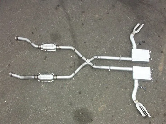

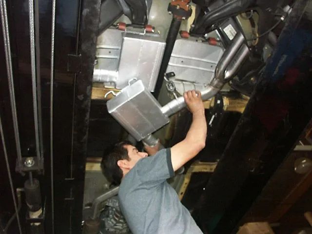

fastgtfairlane said:
spintech has a muffler with the outlet 90 degrees from the inlet that would work perfect for a side exhaust setup.
Never seen it before, but I found some pics of the muffler you're talking about:
That would make it a bit difficult to get the tips to look good as im almost positive that the outlet wont be up towards the front of the car enough.
I'd also rather have the same side in/out so i only had 1 90* bend, rather than 2. The same side in/out would make the turn less harsh.

i just noticed those mufflers have oval outlets for more clearence. spintech makes some of the most badass exhaust systems period. dr gas ftw
