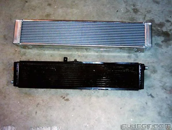

I upgraded my heat exchanger to the gords ford cobra version. I would recommend upgrading your intercooler first though.
Here's a pic of the gords he vs stock saleen he

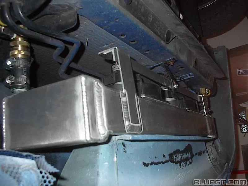

SSTrayer what all needed to be done for that gords to fit properly? And where do u mount your fans?
The fans bolted right in similar to the stock one. I just told Gord the size of the Saleen SPAL fans. You just need hose adapters as the cobra hoses are 1/8th or so bigger than the saleen hoses. We couldn't find the one piece so it took 2 or 3 adapters to get it done. We bought the parts at Napa.
