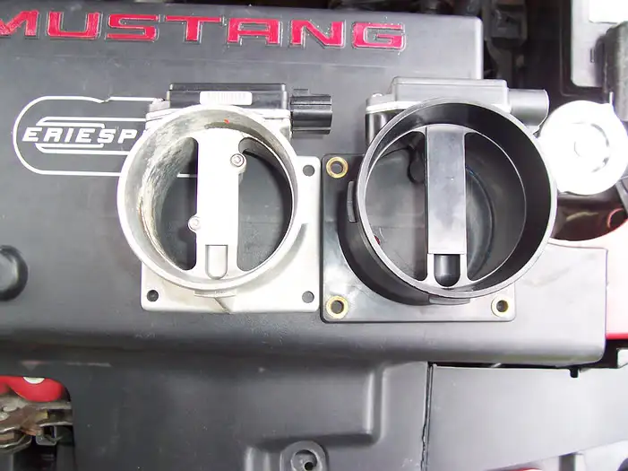

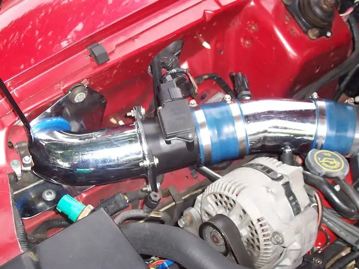

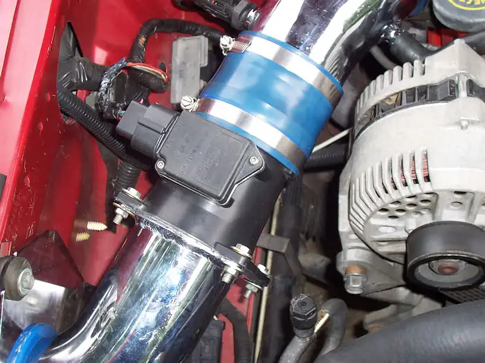

Size of stock MASS air meter on 01 Bullitt and 99+ GT
Its fit except MASS meter
Stock on 02 and up is still 80mm. Ford redesigned the meters for 02 but the size remained the same. Think they changed how the sensor interprets the incoming information.
