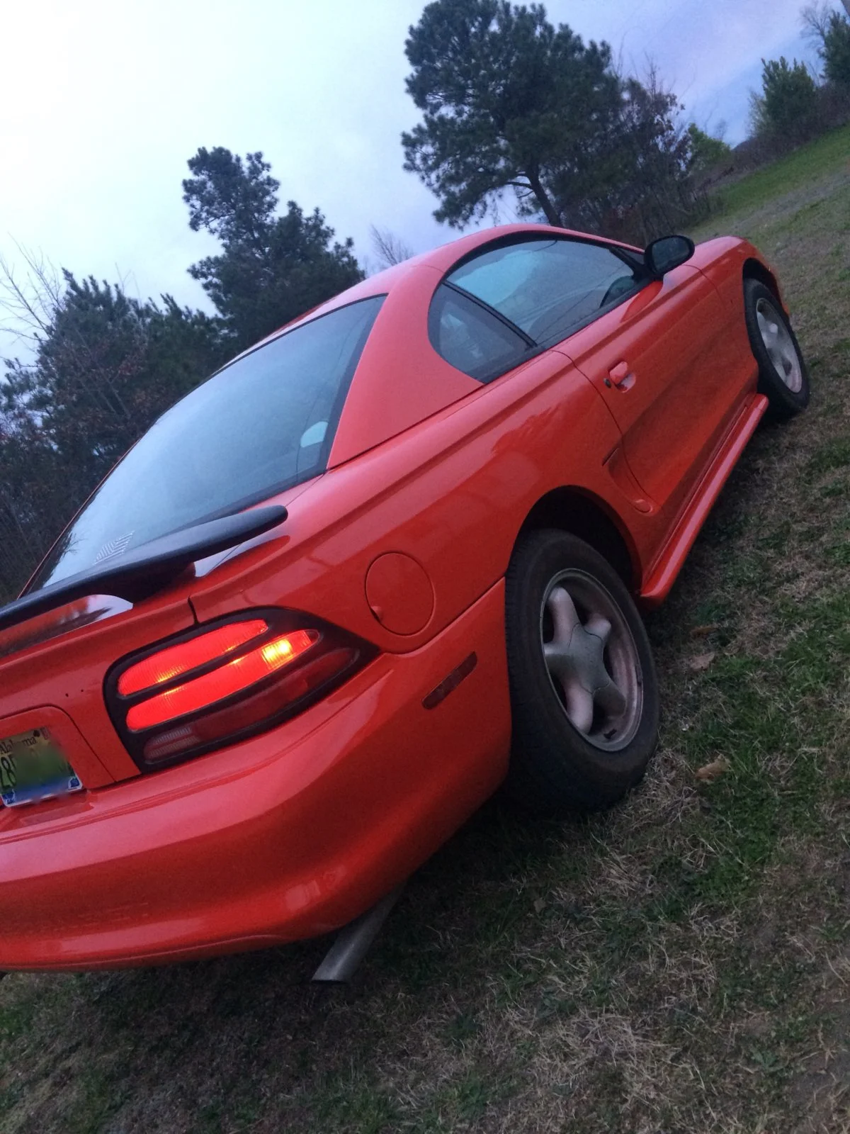

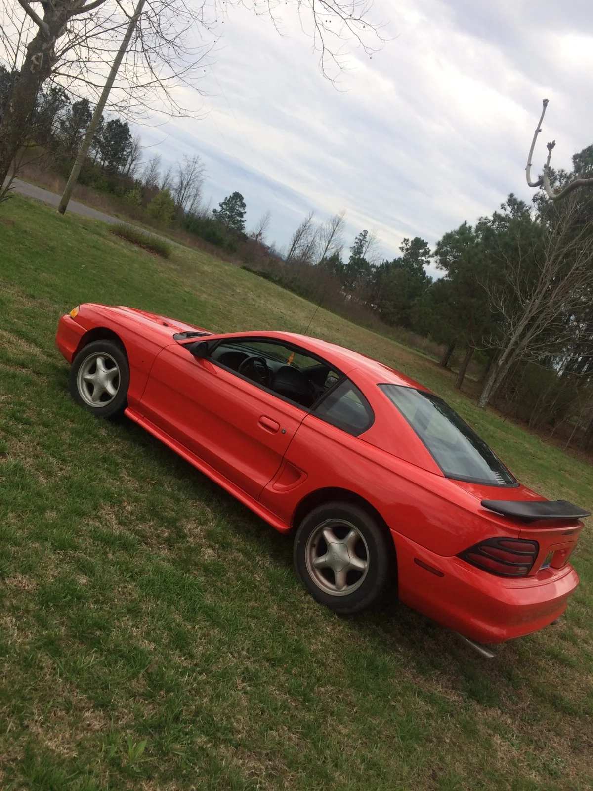

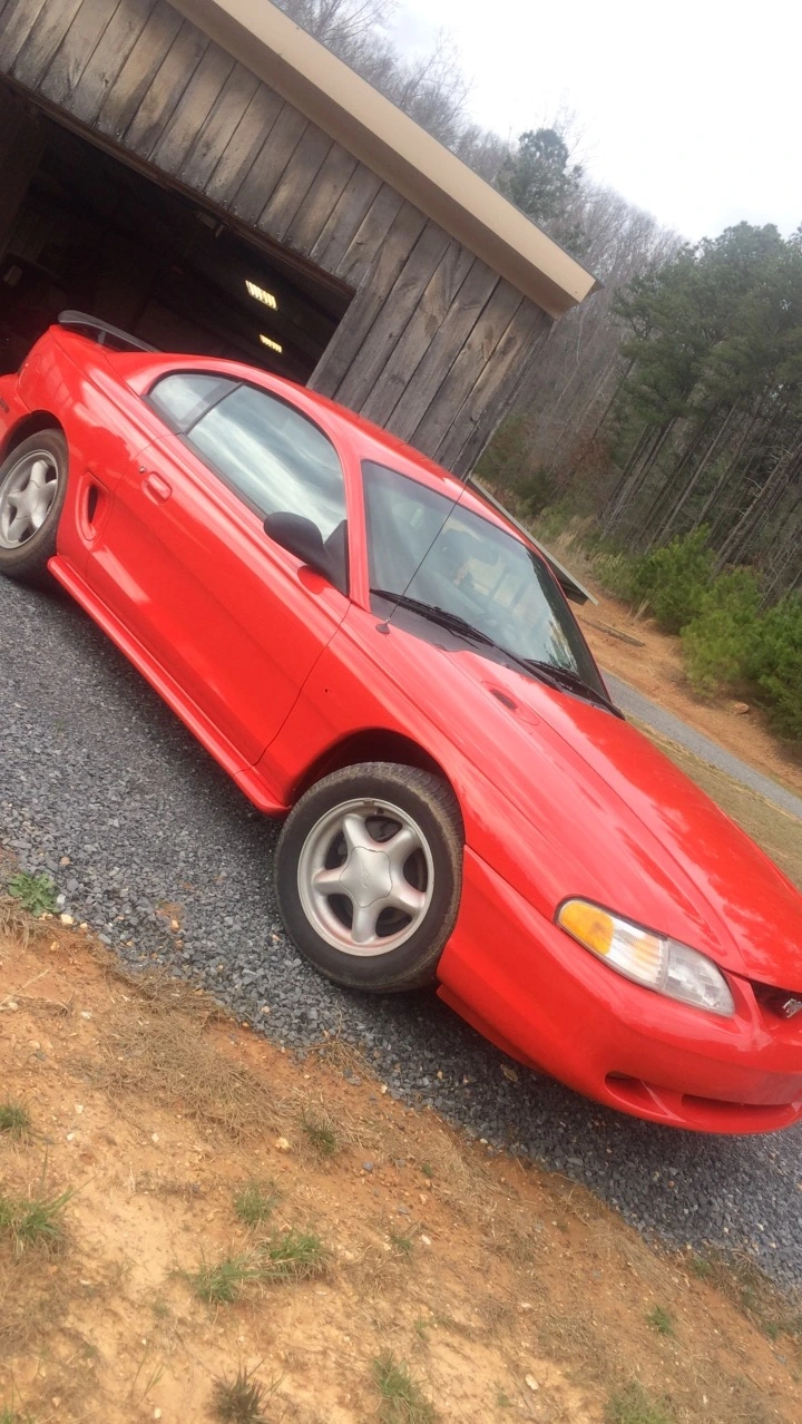

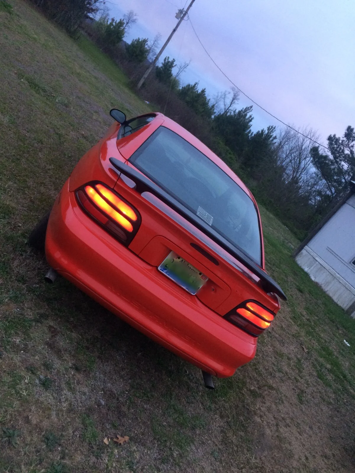

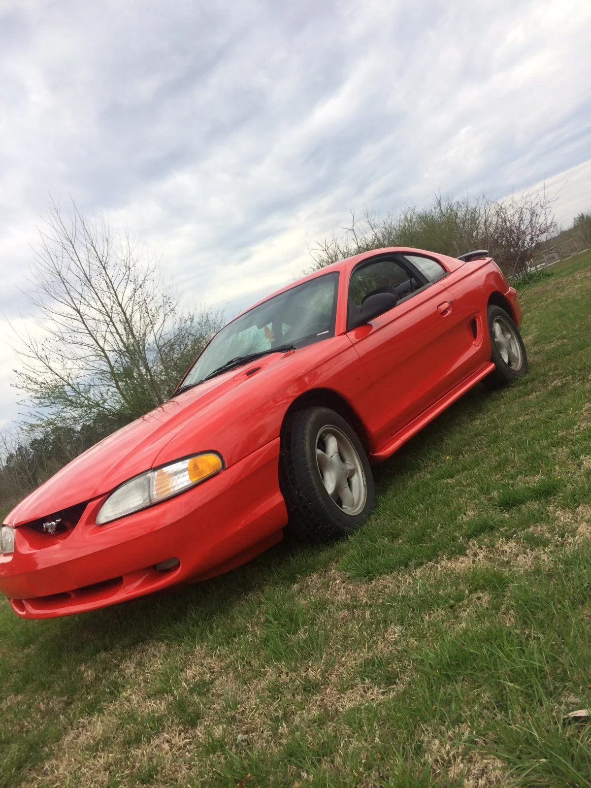

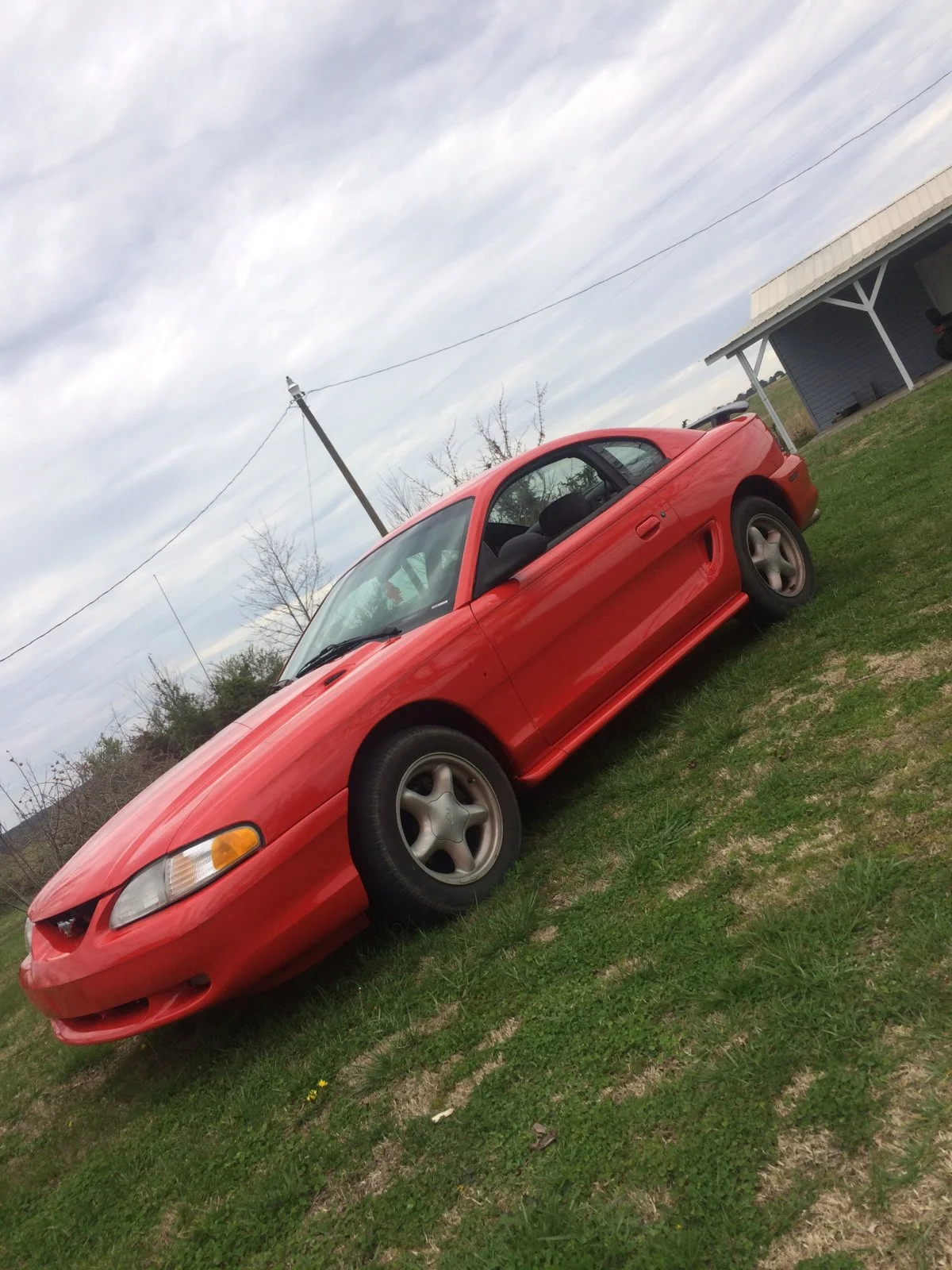

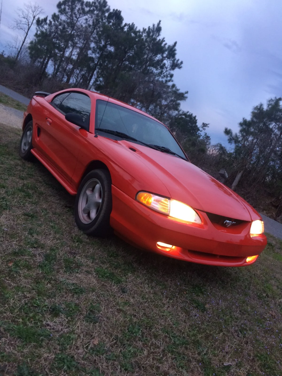

More pictures
Reactions: RaggedGT
Looks great! Much orangepeel in the paint at all? was it a single stage?[/QUOTE
Yeah it’s single stage and yeah it did draw up just a little in a few places, it dried faster than I wanted to and we’re sure that’s what caused it but, the little that’s there doesn’t bother me considering it’s like a whole new car

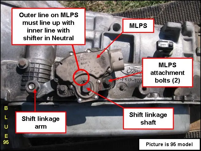

Okay got my exhaust finished up yesterday off road h pipe and flowmasters, anyway now I’m having a problem with the car shifting out of first. It just won’t shift until I let off the throttle, but if I shift manually it seems to do fine. I’ve searched the web and haven’t found anyone talking about this problem soooo please help, I’m not familiar with transmission issues so I need all the help I can get
Aod-E. No Tv cable to adjust.
It is equipped with a Manual Lever Position Switch. If it gets out of adjustment,or goes bad. Will cause all kinds of trouble-that’s where I would start-checking the alignment of the switch with the shifter linkage
Thanks for that, I’ll try to get it on the lift soon and have a look
