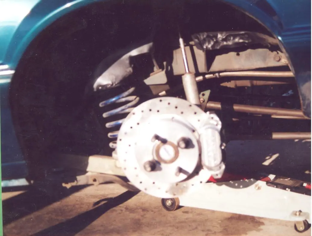

Once your Mustang regularly tops 130 mph in the 1/4 mile it's time to upgrade the cars brakes. Aerospace Components, located in Florida, makes a 4 wheel disc brake kit for the Fox-body Mustang that installs easily, reduces vehicle unsprung weight and greatly reduces stopping distance. I used to stop my Mustang by putting one foot on top of the other and pushing really hard, while praying I didn't run out of shutdown area. The Aerospace parts are top quality, and reasonably priced. They even include instructions on how to modify your brake pedal to increase leverage.:nice:
To find out more about drag racing your 5.0 liter Mustang check out my blog by clicking here
2010 August | Best Racing Tips Win at the Dragstrip
