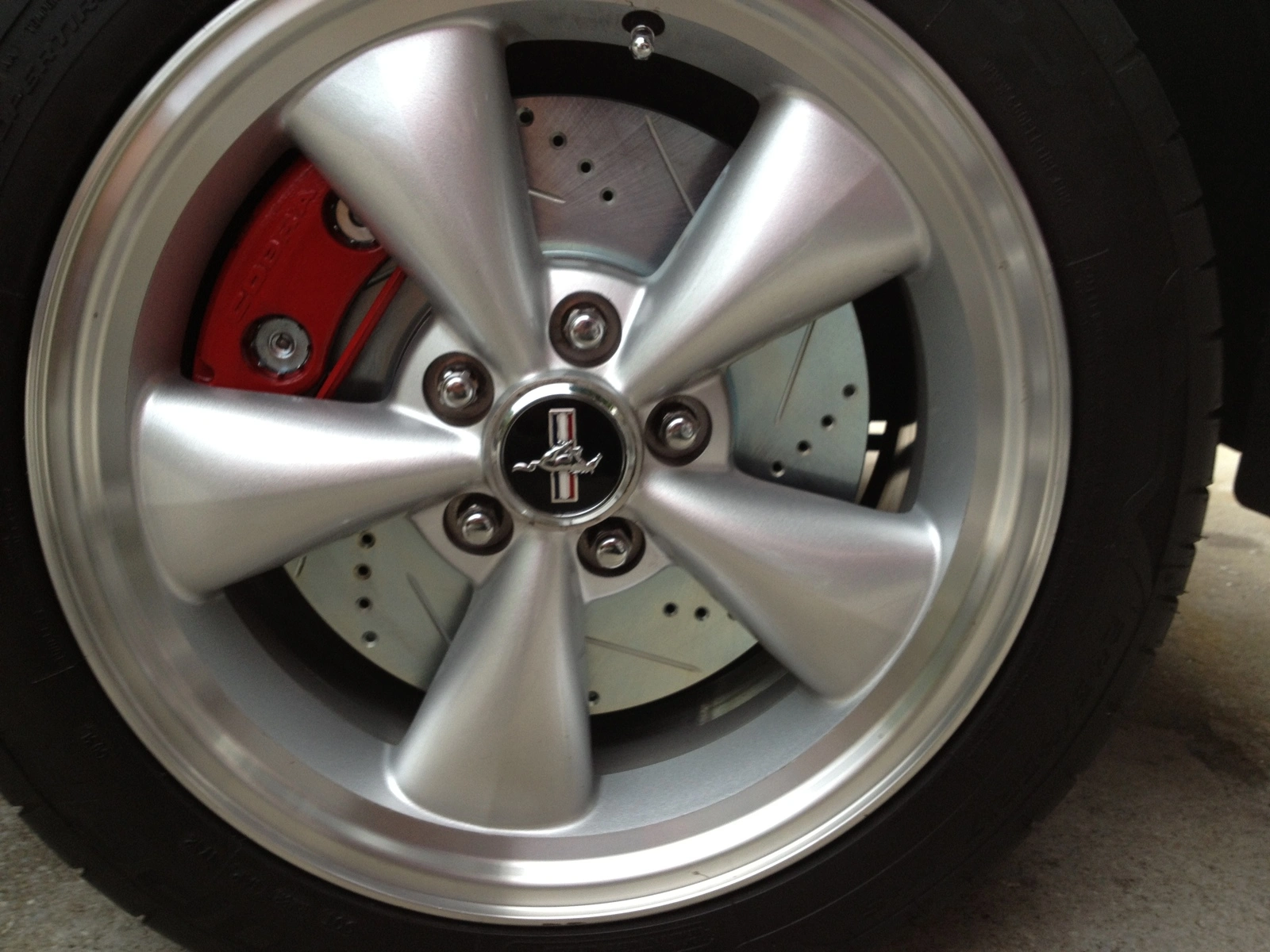

I installed slotted/cross drilled on my 91 vert. I don't really think there is much of an advantage if any though. I just like the way they look.
