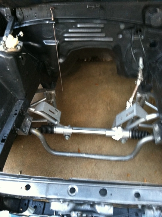

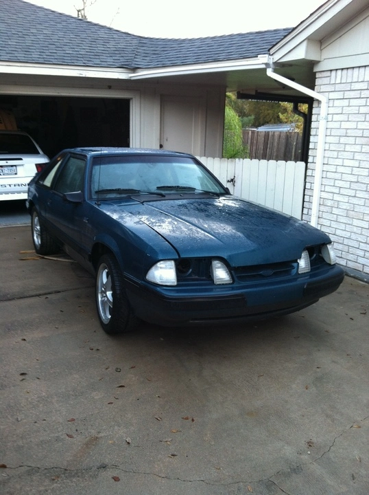

Oh yeah baby. Extra saucy, too. Picked up an 87 LX roller for $1k. Has full UPR front and rear suspension, Flaming River manual rack and shaft, and an 8 pt cage tied in to the subframe connectors. Selling the wheels and tires, K member, and a few other things.
Now for the fun part. Since I have a nice DD 99 GT with all the power it'll ever need, I can make this into a track beater. I've been following a guy with an '86 LX. He has a bone stock LQ9 truck motor. He studded the mains and put in monster injectors. With a BW S480, he's very close to an 8 second pass and he drives it to and from the track. Say what you will, but that's the direction this is going to go.
Here's the car:

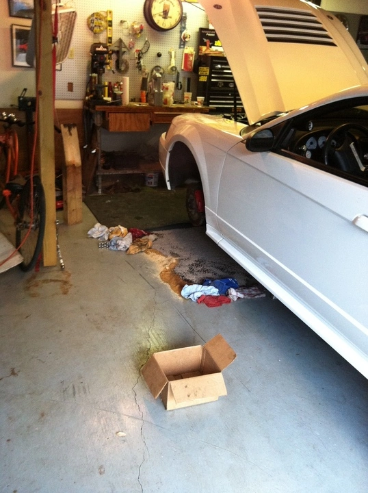

I did an oil change in the '99. When I took off the old filter, I failed to see that the O ring on the old filter stuck to the block. I lubed the new filter, screwed it on, and filled the engine with oil. I started it and after about 10 seconds off idling with no pressure, I shut it down to find that the oil shot out of the filter area towards the P/S pump area that slung 5 quarts of oil EVERYYYWHEREEEEE.
F-M-L.

That sucks, i watched a friend do that like 7 years ago and to this day everytime i change my oil i think of that and double check that the gasket isnt still there

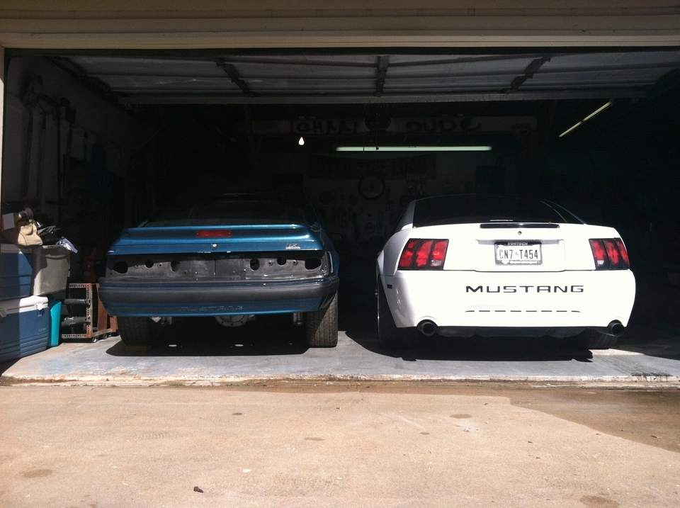

I was a busy beaver today. Managed to clear out room to store both cars inside for when Im offshore

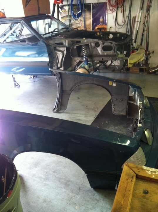

Got the front clip off by the hardest. All the nuts that hold the fenders to the front bumper covers were rusted to hell and back. So it all came off in one piece and will under go surgical separation tomorrow

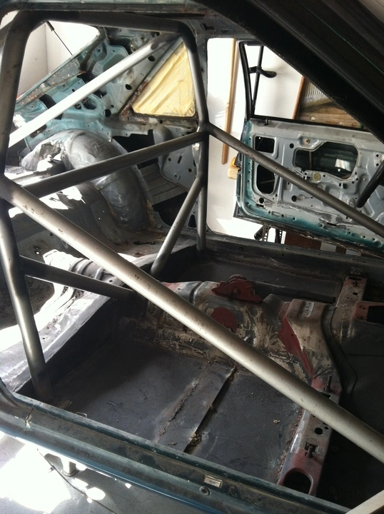

Got the inside cleaned out to see the hack job "floor pans"
Im not upset though. For $1000, it came with a cage and full front and rear suspension. More surgery will be done this week, just gotta wait til X-mas when I buy myself a welder and can start to work on it at my house instead of dragging it to a friends shop like the Hoopty (It's doing very well with the bew owner, BTW.)

Ive been in the garage all evening stripping more stuff off. I'm really excited to have a blank slate. Im going to the hardware store tomorrow to load up on sawzall blades and cutoff wheels. X-mas needs to hurry so I can get a welder and get to work on the body fabrication.
gonna mini-tub, coilover rears, 31 or 33 spline axles and a spool and put in an ARB. There is a LOT of trash welding to fix. Whoever worked on this car before me needs to spend a few hours learning how to weld the right way. Geeeeeez.
I feel like I should also add that this body is already a hack job, so the purists need not cringe. It's only gonna get better after I get done with it.
