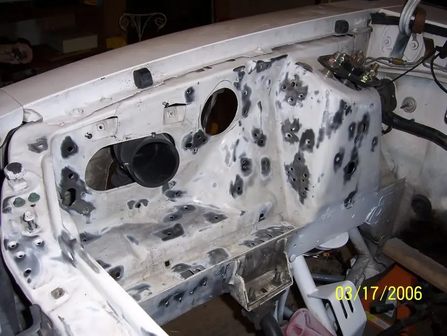

You know why I need a welder? Ever counted how many holes are in a foxy body's firewall and fender wells? They have to go away. Sooooo I've been hunting for a mig weld. Do you have one for sale or know of anyone that does? Or do you have one I could rent from you?

Yes, I am filling the 190 + holes that I counted (thanks John, after the races I had to go home and count them) and will be using the welder for the roll bar, seat brace and seat harness mount.

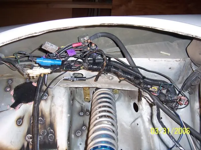

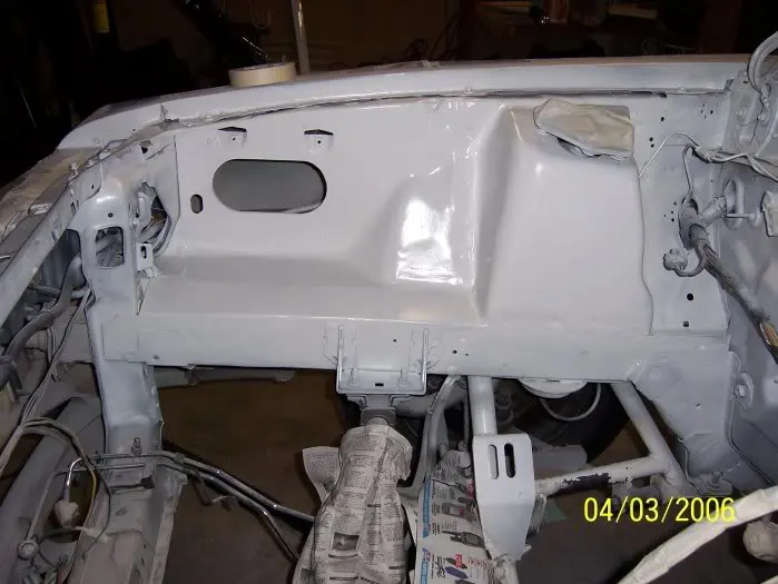

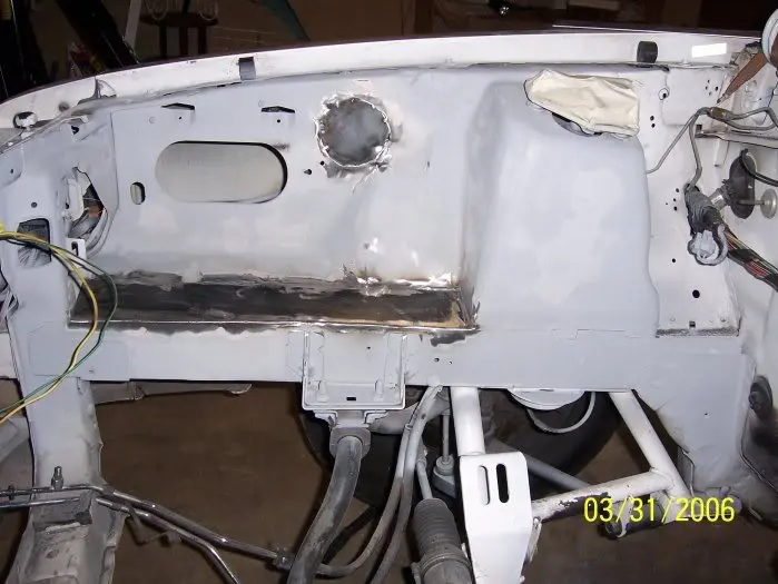

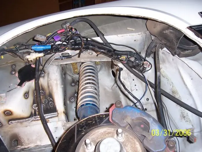

Ben sweet! Sorry it took so long but here is how i did the passenger side wiring. Dont know if it will help any? So thats how many holes i filled? :bang:
There is a big hole on the driverside like the passenger side that i ran those wire's threw:

I will call you for sure on my way home to get that brass. Thanks. Those pictures you sent help, got ideas.
