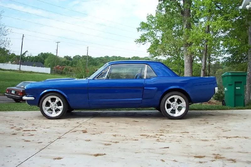

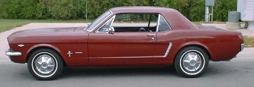

ok...heres teh best I can do for some pictures. This is FUBAK's car (he used to be on her a while ago)
Here you can see the "hump" is still there but the actual driprail is gone. The driprail is just the "L" shaped part that holds the chrome trim. The purpose is to drrp rail from dripping straight down into the car. Cutting off the L shape is shaving the driprails
Here is another car with shaved rails. Dunno who's it is.

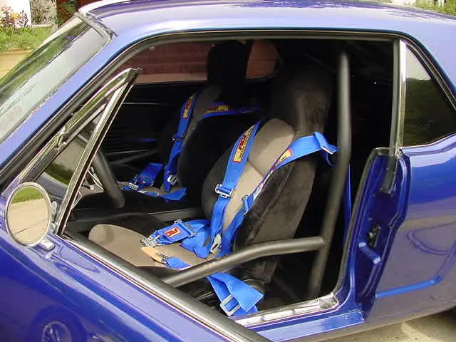

Here is apicture of a 66 coupe Im working on... I completely shaved the hump though, not just the drip rail

I may need that extra set of eyes. You should thank me for looking so ignorant on the matter. :bang:
Thanks for all the pictures. All the cars I have seen had everything removed. If I'm going to go as far as removing the rails, the hump is going as well.
