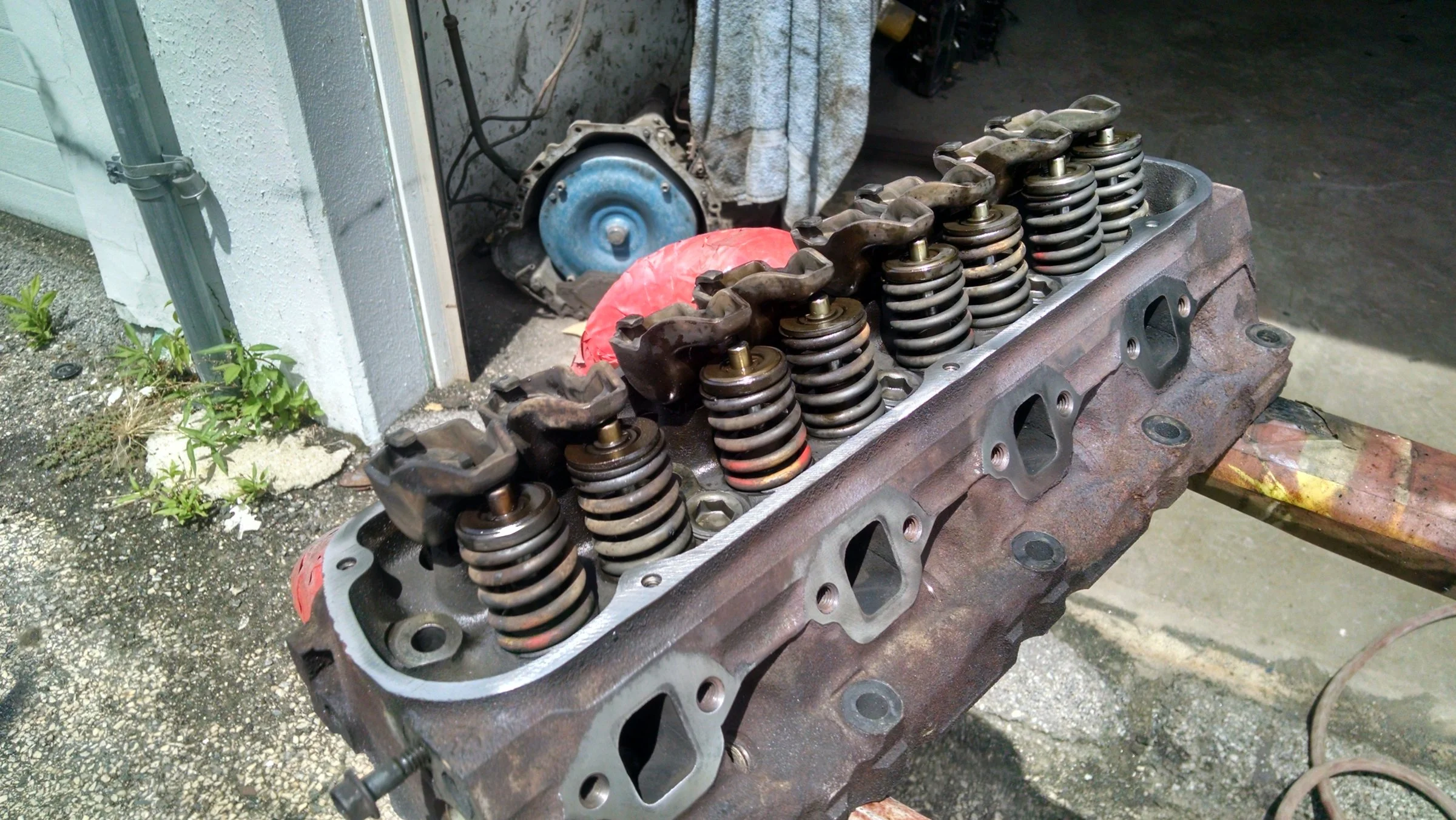

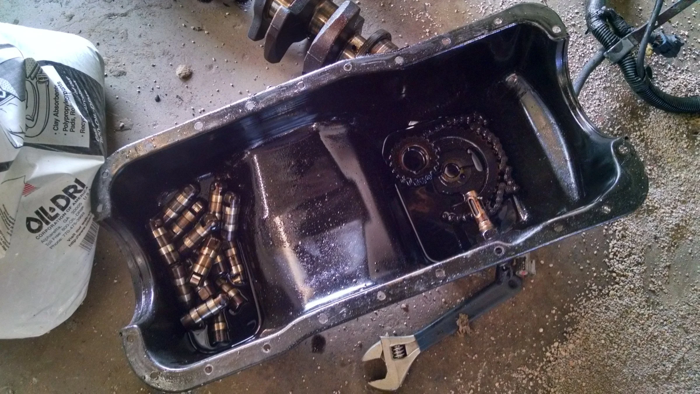

more pics i didnt post

The point is, the stuff in that pile of litter is going to have, litter, dirt crud, oil, steering fluid combo all on and in it. That's your Alternator, AC lines, starter, power steering lines and pump to name a few parts in that mess that are very sensitive to FM (foreign material) so you post in the future about issues with these system youll know why, not saying he wont clean them up and remove the crude but..... best to ask him to :)
5k? I guess everything will be new then.... if not youre not getting a decent deal at all
