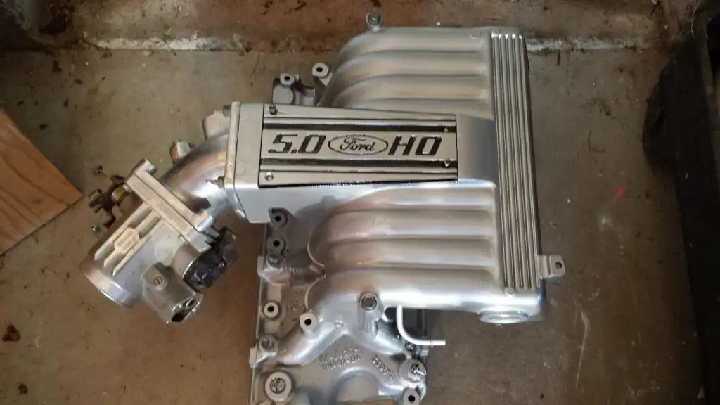

The explorer intake looks very similar to the mustang intake, btw. Just flows more air, makes your engine happier.
Plus, when you want to modify the intake with porting. It's not the original, who gives a rats red bunion.
I'm doing something similar with my '83 t-top coupe. I'm keeping everything original to the car and putting it in storage (as I replace it, that is). I will rebuild the stock engine and transmission and the rest, but then it won't see the light of day again for a long, long time.

Here's an explorer intake
Reactions: A5literMan, Brian Berthold and Mustang5L5
