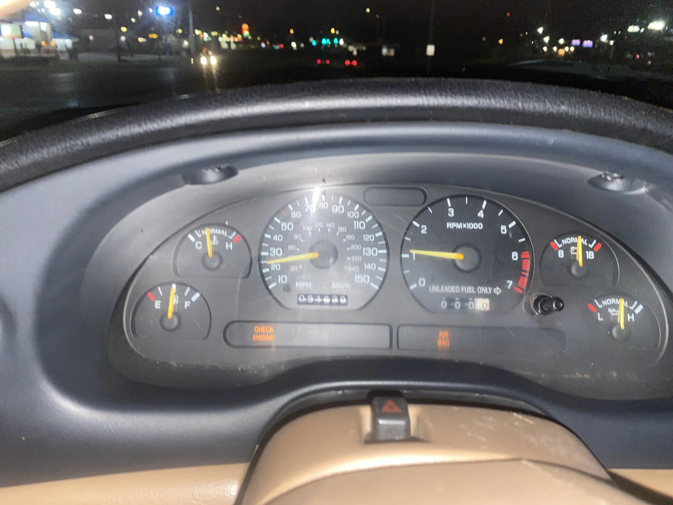

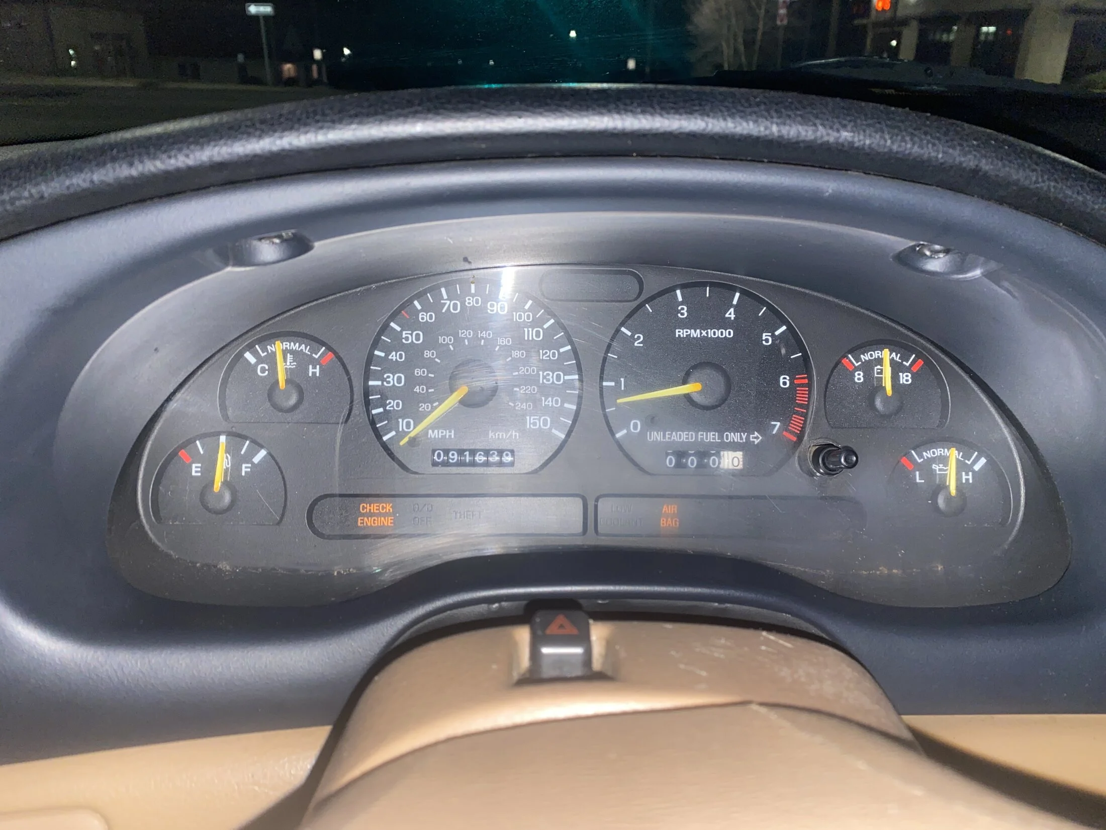

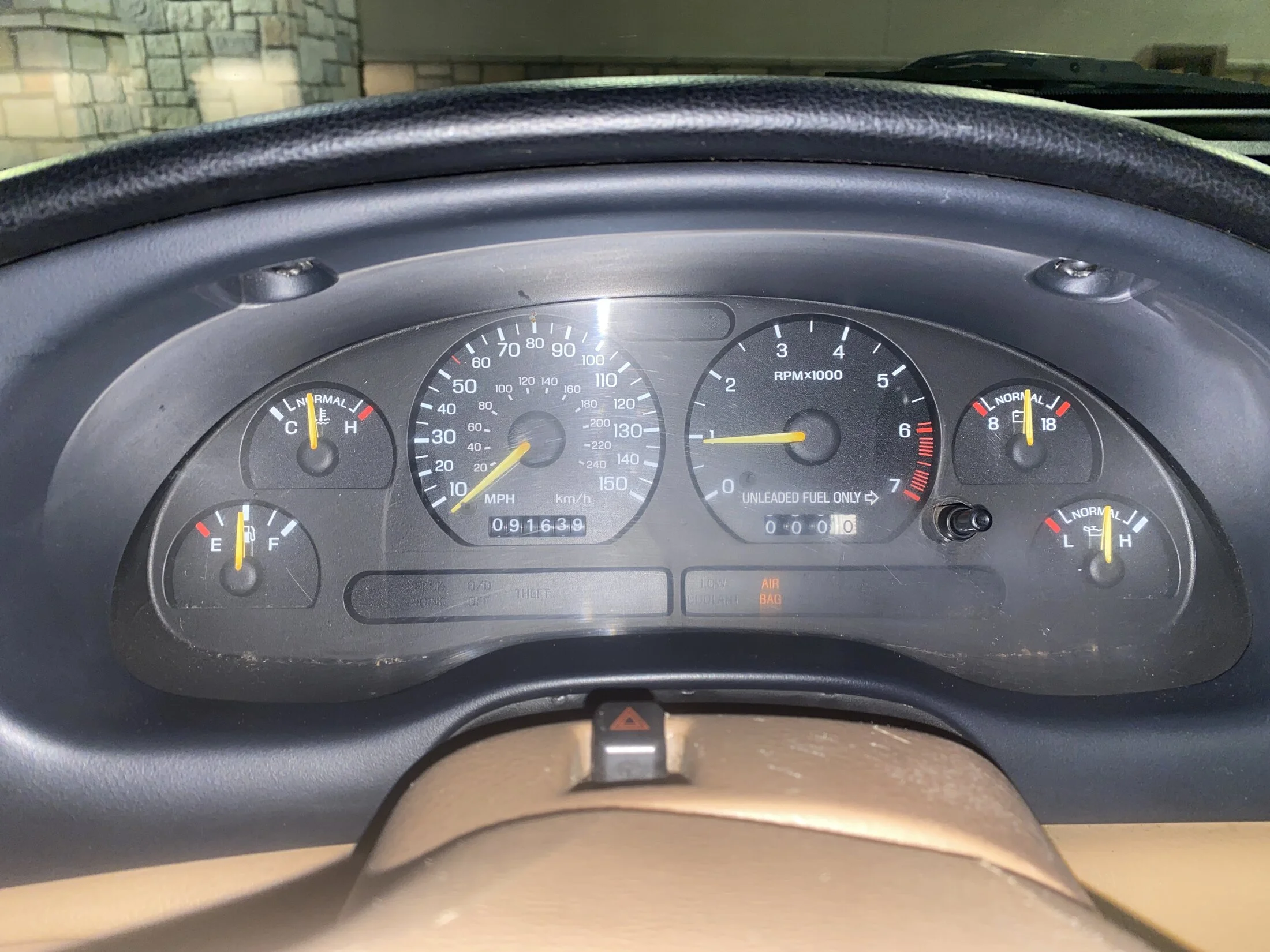

I need help here because I’m having constant TPS issues with throttle adjustment. Where as unhooking the ground isn’t solving it.
I have timing right now
But what is the trick to setting these TPS?
IAC?
Surging idle
Check engine
Rough
Not consistent
There are times where I’ve gotten it running better.
How do I perfect these tps issues and reset?
