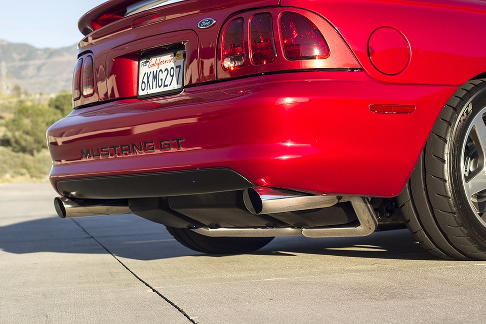

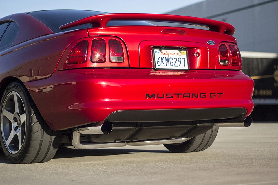

I waited all year to find the time to be able to complete this detailing task. I did the IRS Swap on my SN95 earlier this year. The IRS is complete 03/04 Cobra Spec. The exhaust is Magnaflow catback for 03/04 Cobra. I wanted to get the mirror finish. I followed the SVTP guide for the polished exhaust. Took me about a week woking 4 hours every day. The results were impressive. Totally changed the look of my car and I am so glad I spend the time to do it.
The steps were
3M Automotive Sandpaper
-120 Grit Flap Wheel on Drill
-100 Grit
-320 Grit
-400 Grit
-600 Grit
-1000 Grit
-1500 Grit
-2000 Grit
-Mothers Metal Polish w/ Cotton Buffing Wheel on Drill
-Chemical Guys Vintage Heavy Metal Polish w/ White Hexlogic Pad on Porter Cable 7424XP
-Chemical Guys Vintage Metal Wax w/ White Hexlogic Pad on Porter Cable 7424XP
-Chemical Guys JetSeal 109 *2 coats by hand*
