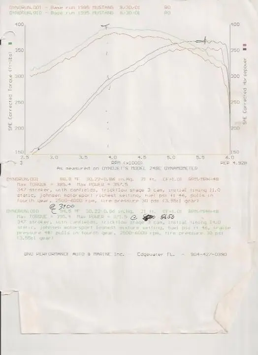

Ok, I found it. This is when I had the engine initially tuned. The dyno did not have a wideband.

Meaning they did not have a wideband so you have no clue what your air/fuel is , you obviously are low on HP for your setup from what I can see and you are obviously way lean on the nitrous tune in the midrange RPM
So there for your wonderful calibrated meter is OFF on its calibration as most of them are as I have said numerous times and you are leaving horsepower and most likely some driveability on the table because you either refuse to get a tune or just dont give a crap but hey its your car do what you want with it
My point being you should not try to tell other people that tuning their car is a not needed when you have done nothing but prove what I have been saying the whole time.
Not going to argue with your stupid A55 anymore so do everybody a favor and quit giving bad advice to people who are on here asking for help and like the OP he has already tried your way and it did not work for him .......

um, he does have a tune. he is also putting down close to 400 horses at the wheels naturally aspirated, and most likely his car is alot faster than is mine (which is not really saying all that much because i did not build a race car).
perhaps you should double check your assumptions to make sure they are accurate.
The guy who dyno tuned the car on motor has been tuning cars for 30 years. He didn't need a wideband. When you've tuned cars for 30 years, you'll be able to pick up on how an engine is running without a bunch of fancy tools. We picked up 17hp and 10ft lb of torque by adjusting fuel pressure and base timing. On the nitrous pull, the car is a hair lean at the mid range, but still puts down over 600 ft lbs of torque, and the power/torque curve is stable. I might add, that is in a useless range of the powerband anyway. The engine makes power consistent with the setup. I might be leaving a few horses on the table by not having a custom cam and a perfect dyno tune, but I'm happy with it. The port work is a little off too. The driveability is great, and I think that's what is so great about Mustangs. You don't have to drop $700 on a dyno tune to enjoy your car. I think a lot of people blame their MAF when the problem is elsewhere. I think my advice is pretty good.

adjusting fuel pressure and base timing is not a tune ....371.5 yea ok , hes closer to 350rwhp than 400 and I am not impressed , my 306 is putting out only about 25-30rwhp less than his car with out of the box parts and smaller heads , as someone else posted the adaptive strategy in the factory tune would negate anything he gained in just a couple days of driving .....
and you shouldnt down play your car its nice and I am sure it would make more than 400rwhp if I got a hold of it
I have a chip, so adaptive is disabled. I put the car on a dyno 6 years later, and it made the same numbers.
