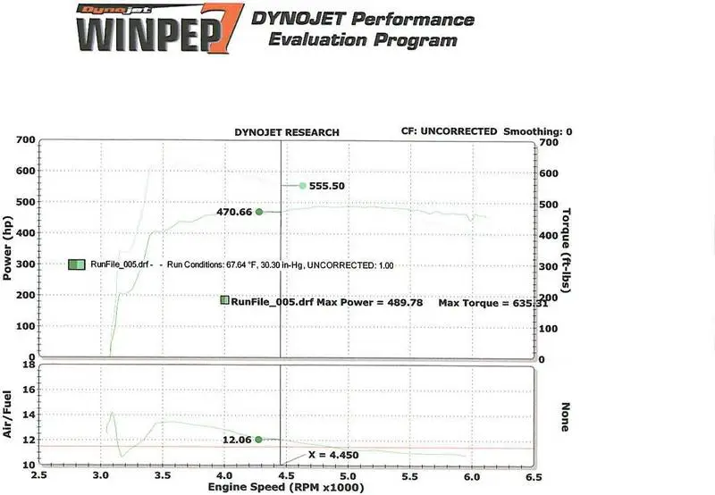

Do you even know who I am , do you know how many cars I have had a wideband on with all brands of so called calibrated meters ? I tune cars everyday , meanwhile you drive your 1 car that just happens to have one of the few meters that was OK out of the box ......
I have about 3 people a week with 94-95 cars send me their SCT chips for reburns on cars that were supposedly dyno tuned that have issues and I have to go back over these other shops work to get the car to run or even idle .......
Id love to see actual wideband readings on your own car
Here you go
I've built plenty of Mustangs in my time, and I have never had a problem with a quality MAF.
Kurt

Is that a nitrous run ? Lets see a motor pull ? and is that with your current setup ? how many passes on it ? Just so you know if that is a nitrous run , you are above 13 on the air/fuel from about 3450 to almost 4000 rpms , thats a little on the lean side FYI
Yes, that is on the nitrous. I wish I made that kind of power on motor. I've never made any passes with that much spray. The most I have ever sprayed at the track was 80, and it got a little sideways towards the end, so I let out. I have a motor dyno sheet somewhere, let me see if I can dig it out.
Kurt
